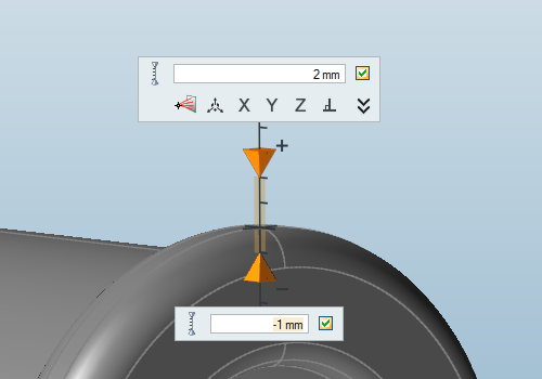

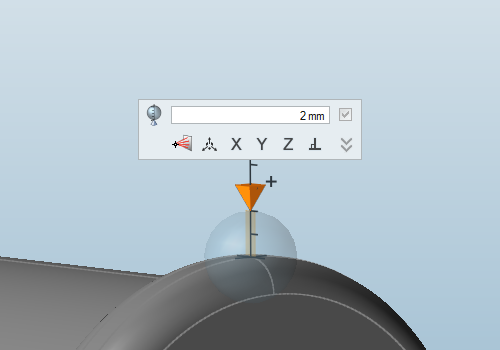

You can choose to limit displacement in one direction or in all directions, as shown in the images below. A displacement constraint in one direction can have an upper bound, lower bound, or both.
Displacement Constraint in One Direction with an Upper and a Lower Bound
Displacement Constraint in All Directions
Apply a Displacement Constraint in All Directions

Microdialog Options
Double-click on a displacement constraint to enter editing mode, which opens a microdialog.
Apply the displacement constraint in one direction or all directions. |
Enter a magnitude or upper and/or lower bound for the displacement constraint. When applying in one direction, use the check boxes to define whether to use a lower and/or upper bound. |
