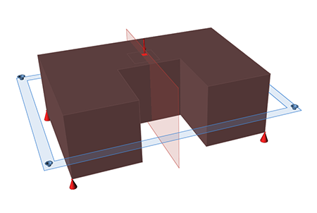

Figure 1. Design Space

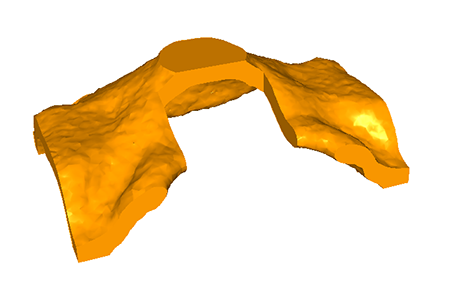

Figure 2. Optimized Shape with Stamping Applied
