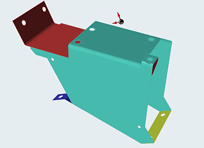

Figure 1. Design Space
Figure 2. Optimized Shape

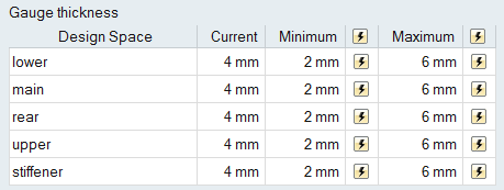

Gauge Thickness
The current gauge thickness for each design space is displayed in the Run Optimization window, and can be defined there or in the Property Editor.
The target Minimum and Maximum gauge thickness are defined by the user, and default to 20% above or below current gauge thickness.
