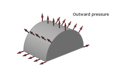

A pressure is a distributed force that acts perpendicular to every point along the face. Use the Apply Pressure tool on the Loads icon to apply a pressure.
Pressures typically arise from gases or liquids pressing on a face and can act in either the inward or outward direction on a solid. To apply a distributed force to a face that acts in a single uniform direction across the entire face, use a force instead of a pressure.

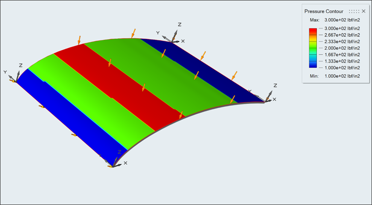

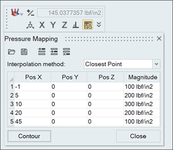

Pressure Mapping
Use the Pressure Mapping table to enter the position and magnitude of your pressure data. You can also import this data in .csv format
You can apply a non-uniform distributed pressure using an option in the microdialog.
Selecting the Non-Uniform Pressure option opens the Pressure Mapping table, where you can enter the position and magnitude of your pressure data. You can also import this data in .csv format.
Click the Contour button on the table to visualize the contours.
