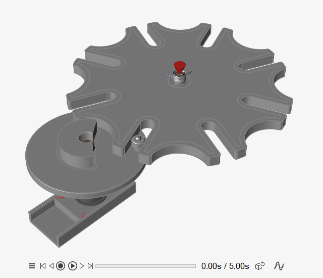

Run Motion Analysis to View Mechanism Behavior
- Click the Motion tab on the ribbon.
Click the Quick Run button on the Analyze Motion tool to
see the model in motion, and let the model run to completion.
The striker part passes right through the Geneva wheel because the contact between the parts has not been defined yet. The slider pulls away from the Geneva wheel after a while.
When the analysis has finished, click the
icon
on the animation toolbar to play back the motion results.
Right-click in the modeling window, or left-click the Review Motion
Results tool to exit review mode.

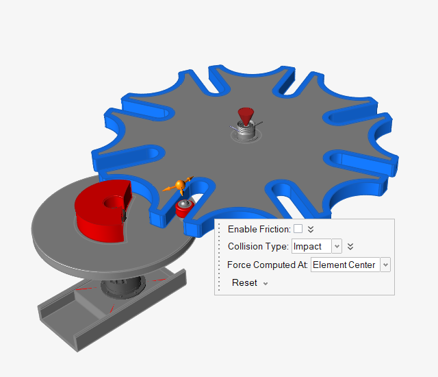

Create a Motion Contact Between Three Parts

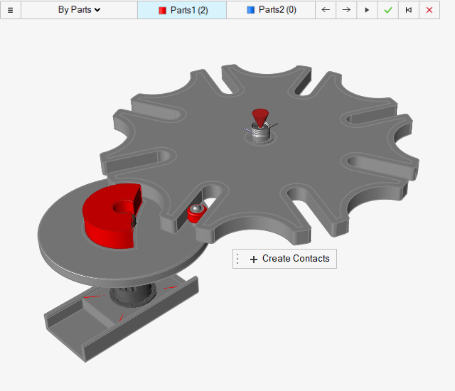

Click the motion Contacts tool.
Click the Cam part.
The part turns red, and the Parts1 button now has a count of (1) part.
Click the Striker part.
It turns red and the Parts1 count is incremented to (2).

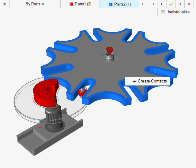

- Click the Parts2 button.
Click the Geneva Wheel Partition 2 part at the periphery
of the Geneva wheel assembly.
The part turns blue, and the Parts2 button now has a count of (1) part.
Click the
button. One contact is created as shown in the
counter on the ribbon, and you are placed in edit mode.

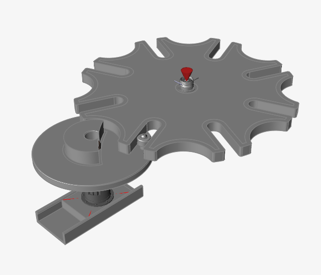

Run a Motion Analysis with the Motion Contact Defined
Click the
icon in the view
controls.
Click the stored view called Start View, then close the
Views window.
see the model in motion. Let it run to completion, but do not exit review mode.
This time the parts are not passing through each other, and you are seeing 3D
contact behavior.

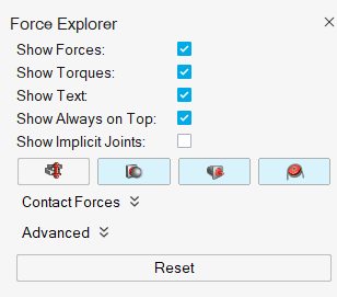

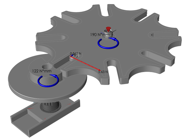

Review Motion Analysis Results Using the Force Explorer
Change the Time on the animation toolbar to
0.30 s by entering a value in the field or by
dragging the slider bar.

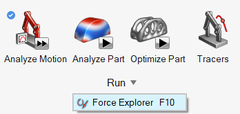

Click Run on the Motion ribbon, and then click
Force Explorer.
The Force Explorer appears. To undock the Force Explorer, click the title area and drag to the graphics area.

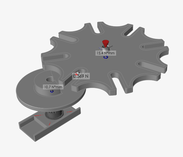

Press F to fit the model in the view.
Press the Play button on the animation toolbar. Notice
how the contact forces and torques in the motor and torsion spring develop as
the Geneva wheel is indexed around its axis.
- In the Force Explorer, toggle some of the checkboxes and entity buttons on/off, and experiment with some of the advanced options.
- In the Force Explorer, click the Reset button to revert to the default settings.
- Double-right-click in the modeling window to exit review mode, but notice that Force Explorer stays visible-which is what we want.

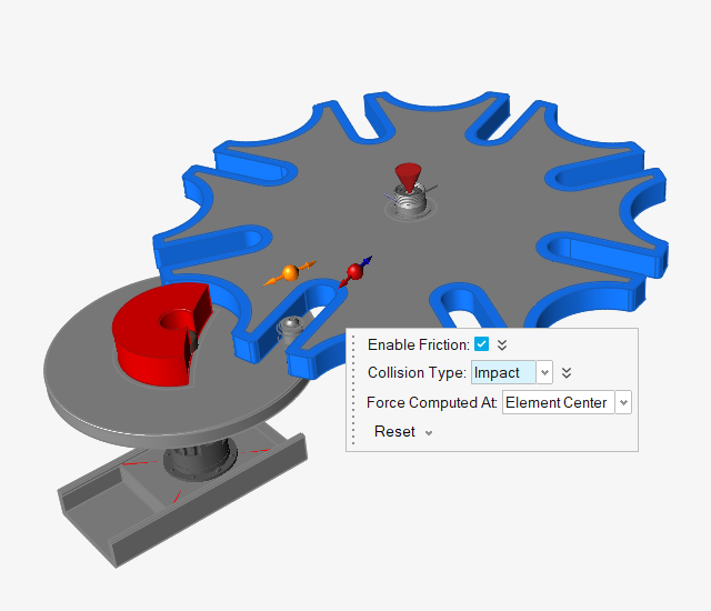

Edit the Motion Contact to Include Friction

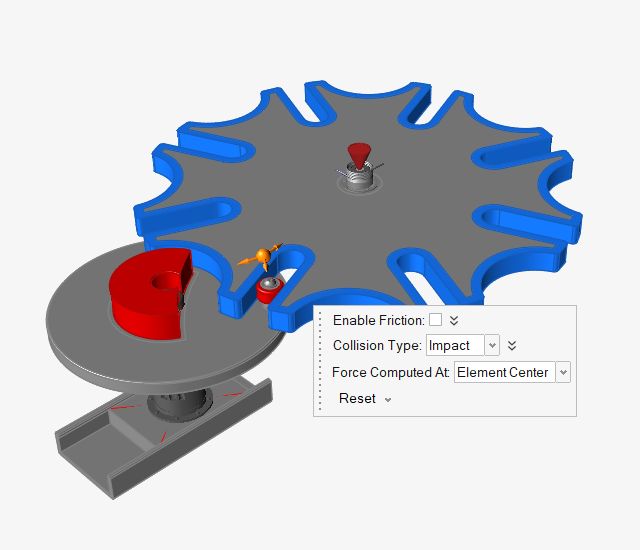

Hold Ctrl while clicking the motion
Contacts tool. This puts you in edit mode for Motion
Contact 1.
The contact is selected in the Model Browser, and the red and blue contact pairs are shown.
Tip: Alternatively, you can enter edit mode while in the motion Contacts tool by selecting a contact in the Model Browser or selecting the motion contacts glyph in the modeling window. -
Select Enable friction.

Click the Individualize check box on the guide bar and
click the
button.

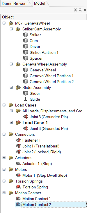

The counter on the Contacts icon now reports that there are two contacts in the model. This operation separates the single contact between three parts into two contacts between two part pairs. The reason that you would individualize contacts is to plot the motion contact results for each contact pair.

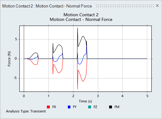

Plot Motion Contact Results
In the Model Browser, click Motion Contact 2.
- Right-click the plot, then click Normal Force.
Right-click the plot again, then click Pop Out.
Right-click the plot, then click Tangential Force.
