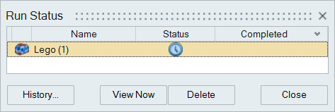

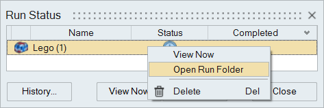

Manually copy a prepared model file and queue it on a remote jobs server.
- You can start a manual remote run and close your local version of Inspire. After copying the results back, you can load your results from the Run History.
