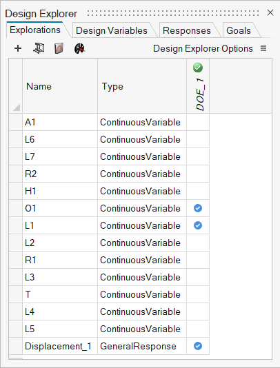

From the Design Explorer ribbon, select the Explorations
tool.
Now that you have entered the Explorations step of the Design Explorer workflow, you can create, review, and modify explorations.
On the Explorations tab, click + Add Exploration, and
then select an exploration type.
