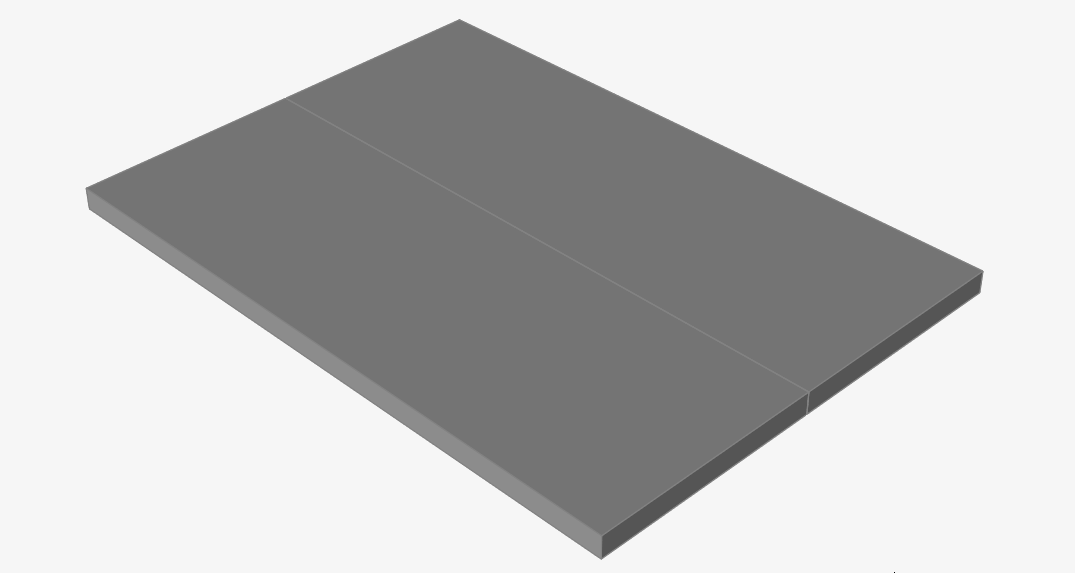

- Import die geometry

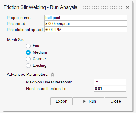

- Launch HyperXtrude solver to run friction stir welding analysis

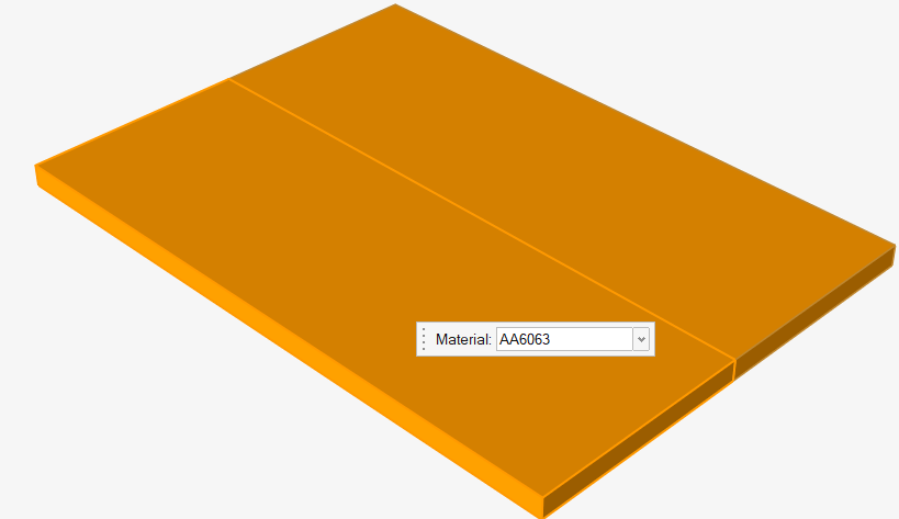

Select Materials
Identify the Plates

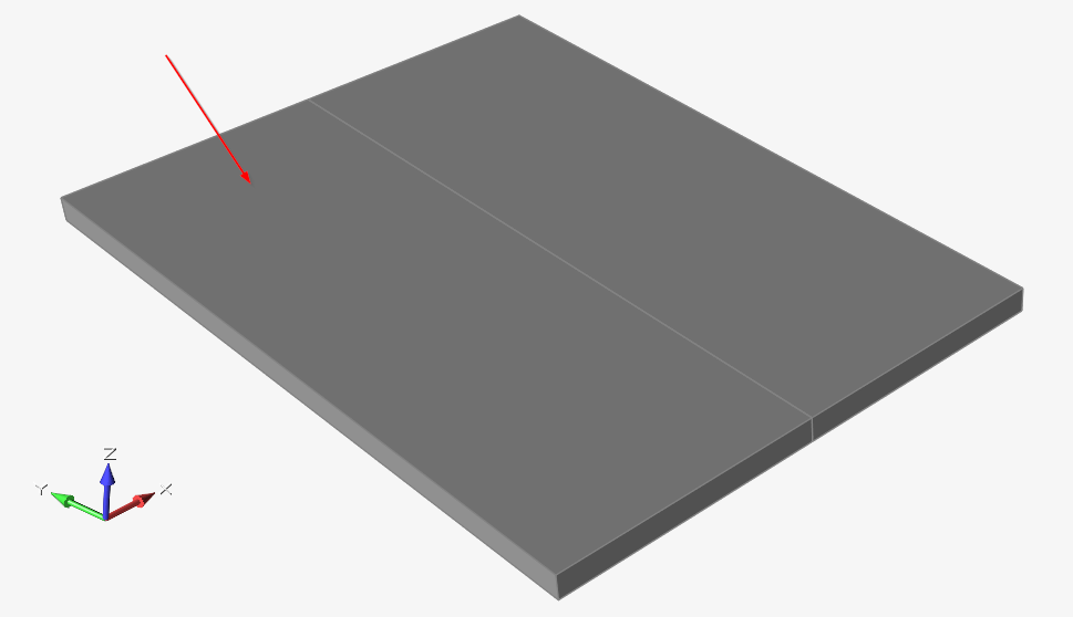

Orient the Model

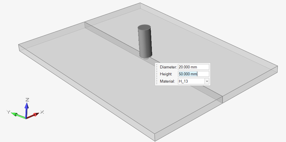

Create the Pin

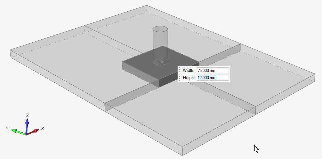

Create the Shoulder
Create HAZ
