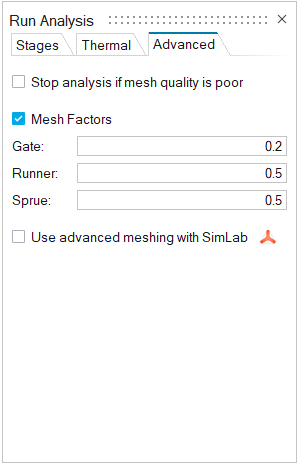

Filling, Packing, Cooling HTC Enter the Heat Transfer Coefficient. W/m2K for each stage of the process. Room temperature Enter the ambient temperature of the work environment Virtual mold temperature Set the desired starting temperature for the mold. Advanced Stop analysis if mesh quality is poor If this option is selected, Inspire will run a quality check on the mesh settings. If the mesh quality is not high enough to yield accurate results, Inspire will stop the simulation. To mitigate this risk, review mesh size and mesh factors, or enable the Use advanced meshing with SimLab option. Mesh Factors Enable this option to manually adjust the mesh size for each component: Gate, Runner, and Sprue. Enter a factor to multiply the Element Size by. The available range for each of the components is 0.1-5. This option will be unavailable if Auto Mesh is enabled.
Use advanced meshing with SimLab If this option is selected, SimLab will be launched when you run an analysis so that you can perform advanced meshing. This option will be unavailable if Auto Mesh is enabled. Note: SimLab must be installed for this feature to work. -
