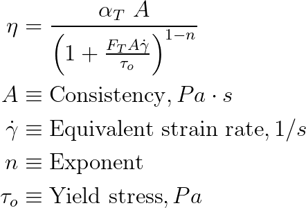

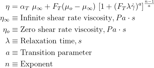

Rhealogical Properties

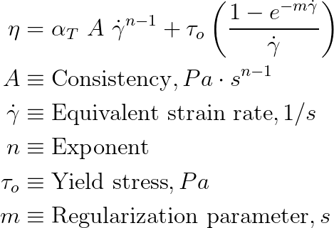

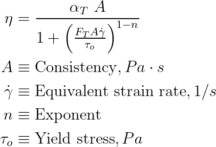

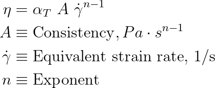

The solver models the rheology of the polymer using generalized Newtonian models. Models currently available in the solver compute viscosity as a function of effective shear rate and temperature. All the constitutive models are set by defining an appropriate combination of : a) an empirical model relating viscosity with shear rate and b) the temperature dependence. Temperature dependence is denoted using the symbol αT.
![](../../../images/figures/mold/Mold_material_equation_of_state_5.png)
Review the properties on the Rhealogical tab for the specified material:
Material Property | Description |
Constitutive Model | Five models are included in the Materials Database. Select the model
appropriate for your material choice. Review the Exponent, Consistency and Relative
Shear Stress for your chosen model.

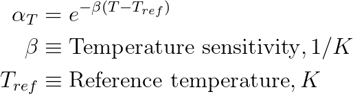

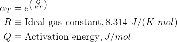

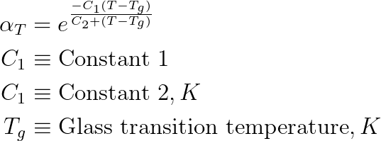

Temperature Dependence | Temperature dependency of the viscosity can be modeled through one of the
following ways. The chosen model is specified with the temperature dependence
parameter, which is set with an integer value from 0 to 3:

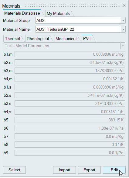

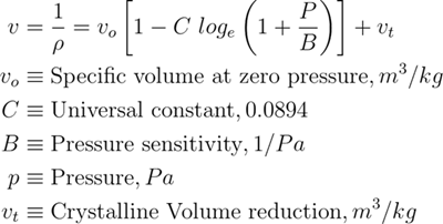

Equation of State - PVT Data
The pressure-volume-temperature (PVT) relationship is modeled using Tait's two-phase equation of state. The PVT behavior of the polymer in both solid and melt state is described using 14 parameters. These parameters are indicated with letter b and with a numerical subscript (1-9) and a letter subscript (m=melt, s=solid). The following equations describe the equation of state and its parameters.
![](../../../images/figures/mold/Mold_material_equation_of_state_1.png)
![](../../../images/figures/mold/Mold_material_equation_of_state_2.png)
![](../../../images/figures/mold/Mold_material_equation_of_state_3.png)
![](../../../images/figures/mold/Mold_material_equation_of_state_4.png)
Parameters b5 to b9 are identical for both melt and solid. They are repeated for simplicity of the data file and structure of the code.
TAIT_PARAMETERS_MOLTEN_STATE = [b1m , b2m, b3m, b4m, b5, b6, b7, b8, b9]
TAIT_PARAMETERS_SOLID_STATE = [b1s, b2s, b3s, b4s, b5, b6, b7, b8, b9]
Database keywords: TAIT_PARAMETERS_MOLTEN_STATE, TAIT_PARAMETERS_SOLID_STATEProcessing Data
