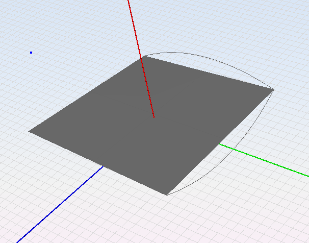

Example:
For this example, one surface must be defined.>rebuildSurfaceU-Degree [integer](default=2): 1V-Degree [integer](default=2): 1Points in u direction [integer](default=3): 2Points in v direction [integer](default=3): 2> Original surface:
Figure 1. Original surface used for the rebuildSurface operation
Resulting surface:
Figure 2. Resulting surface after the rebuildSurface operation
