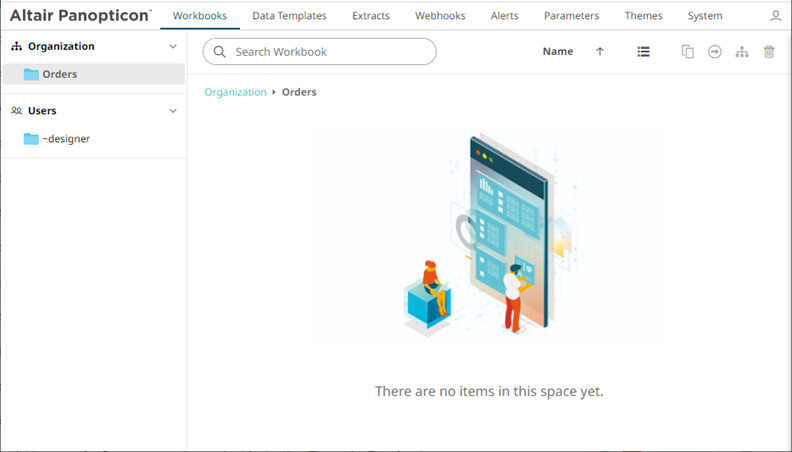

1.     On the Workbooks tab, right-click on the topmost folder, and select New Folder.

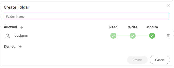

The Create Folder dialog displays.
   NOTE
·         Everyone is available in the Allowed section by default.
·         Removing the Everyone group will mean that the folder and its subfolders will not be available for public access.
·         The default group permissions on the root folder are WRITE + READ.
2.     Enter a Folder Name.
3.     Proceed to defining the Authorization to Allowed or Denied groups and users.
4.     Click .
The new folder is displayed on the expanded Folder hierarchy list and on the Root Folder list.
