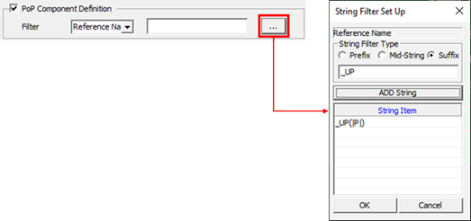

PoP Component Definition: For parts with high component densities, such
as mobile phones and digital cameras, a package on package (PoP) design
is sometimes applied. Option to check if the position of pin 1 of the
upper part of the PoP is the same as the position of pin 1 of the lower
part. The Filter is set through the string filter to recognize the top
part of the POP from the mount data. Figure 1.
In Figure 1,
the part with the same reference name and the suffix _UP is recognized
as the top material of the PoP. For example, if U100 parts and U100_UP
parts exist in the mounting data, U100 parts are recognized as lower
parts and U100_UP parts as upper parts.
