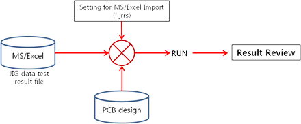

The Result Review displays the inspection JIG data on the screen. To activate this function, set the Setting for Result Data in the Setting menu. The result data can be extracted from the bare board tester with MS Excel format.
Click
to select the Excel file.
