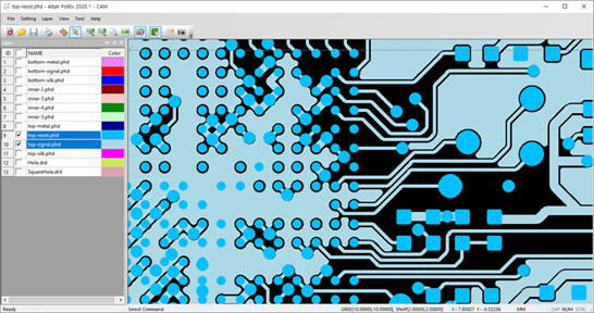

Check the difference in the Gerber file. After reading the two Gerber files primarily, it is used to manage the revision to confirm the change.
It offers three types which have XOR, Merge and Diff-Get.
Figure 4.
XOR
- XOR, only the wrong part of both Gerber files displays on the screen.
Figure 5. - Layer selection you want to compare
- Right-click on the list > .

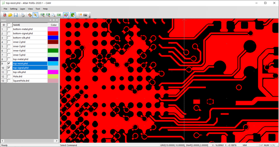

Merge
Figure 6.
