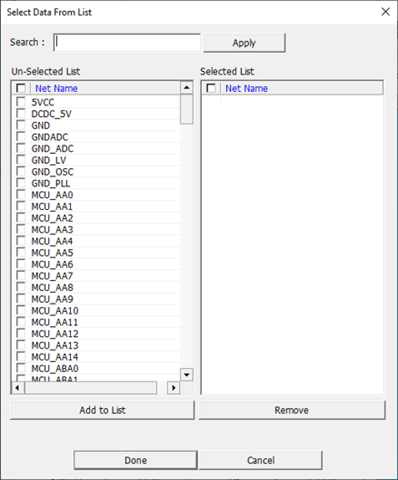

- Nets: Selecting the nets. You can select target nets with the net name.
- Net Name Filter: Use the net name filtering box to select nets and add them to the item list.
- Net Name: The following image describes component selection with the
reference name.
Figure 1. - Net lists shown in design.
- Un-Selected List: The selected items.
- Selected List: Move the selected item to the Selected List item.
- Remove: Delete the item in the Selected List.
- Search: Net name searching menu.
A*: Net name starting with string A.
*B: Net name ending with string B.
A*B: Net name string starting with A and ending with B.

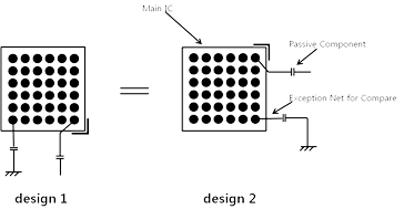

Block Design Definition: You can define the main IC device and passive device. For defined devices, if there is net between them, PollEx Cross Probe checks the nets difference between two designs. (* if routing patterns in two designs have different rotation but the same topologies, PollEx Cross Probe decides that they are the same.)
- Main ICs: Select main devices with part name. For example, CROSS PROBEU and DDR chipsets.
- Passive Components: Select passive device with part name.
- Except Nets for Comparison: Select exception nets from the list. For example, GND and Power.

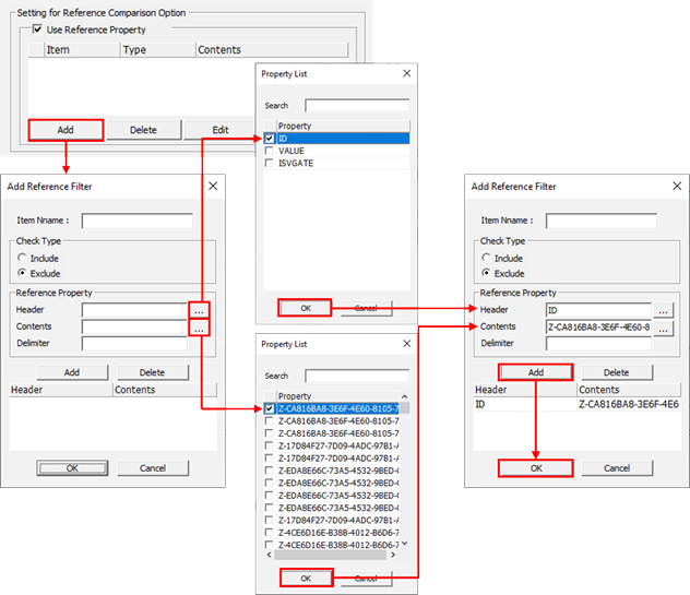

- Setting for Reference Comparison Option
- Use Reference Property: Activate or deactivate the checkbox for components
during component comparing. You can decide to checking or un-check certain
components (reference designator) that have specified properties. Click
Add to open the filter window.
