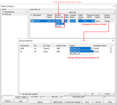

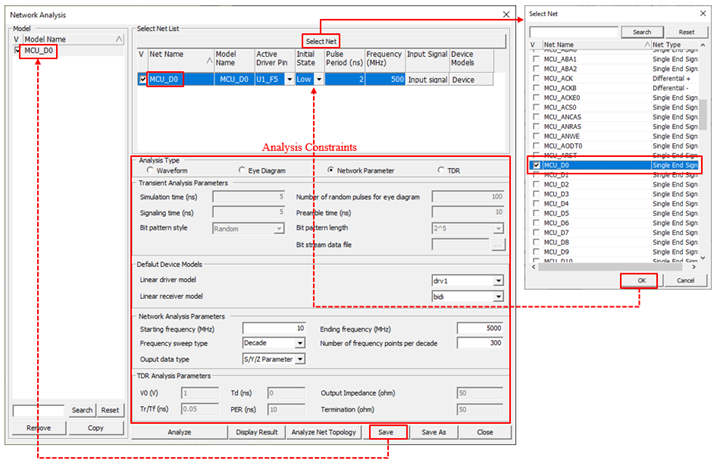

Creating a network analysis model starts with selecting a net from the net listing.
The net name is initially assigned to the model name which can be changed by users.
When multiple output or bi-directional pins are available for the net, one of them

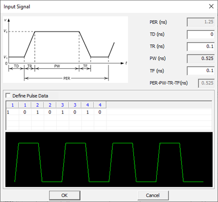

must be selected for active driver pin. The pulse period of input signal is
automatically obtained from the operating frequency of the net. Clicking
Input Signal allows you to view the input signal property
and change them. After checking Define Pulse Data, you can also change the high/low
state of each bit of the input signal. Figure 2.
Clicking Device Models allows you to view the device models
selected for the output and input pins. Users can change the device model selection
when multiple models are available for the pin. Figure 3.
Prior to running analysis, you need to select an analysis type and make necessary
changes on the analysis control parameters. Available analysis types are:
Waveform
Eye Diagram
Network Parameter
TDR
Analysis run control parameters vary with the analysis type and are initialized
with the ones shown in Electrical Analysis Constraints menu.

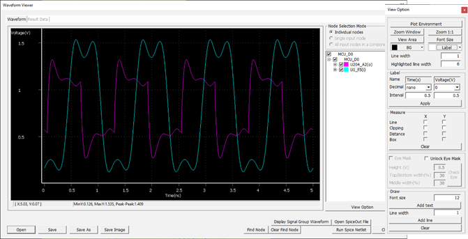

makes the differential pair node be automatically selected or unselected. Many
displays and measuring options are available in the waveform viewer. The analysis
results can be listed in a table form by clicking the Result
Data tab. They can be also shown in MS Excel. The waveform data can
be saved in a file with the use of Save or Save As menu. Save menu saves the file in
Signal_Integrity/Waveform directory under the PCB design
job folder. The model name plus .spw is used for the file name.
The saved waveform data can be read into the waveform viewer alone or together with
other waveform data for a review or comparison. Figure 4.

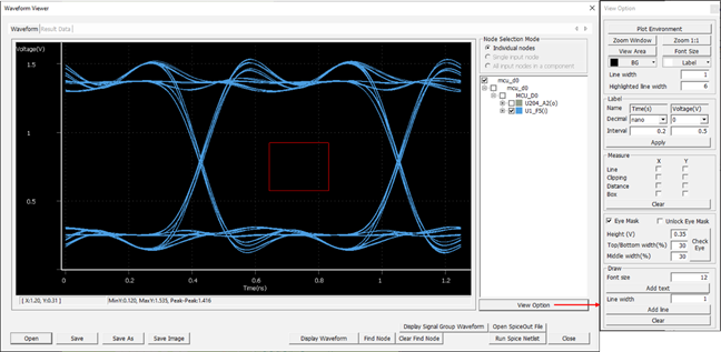

Eye Diagram Analysis
Eye Diagram analysis is running transient circuit simulation on the network model to
obtain eye diagrams at the input nodes. An eye diagram or eye pattern is obtained
from overlapping multiple waveforms at the receiver node of a net generated by
randomly selected high/low states of the input signals for the selected net and
adjacent nets. The coupling effects from the adjacent nets are reflected in the
waveforms. Prior to running analysis, users can change the analysis control
parameters such as the number of random pulses and bit pattern style.
Upon completion of the analysis, the eye diagrams at input nodes are displayed in the
waveform viewer. Check Eye menu allows users to check if the eye size is large
enough with the use of eye mask. The height and width values of the eye mask are
initialized with the ones defined for the net, and users can change them. Among many
available display and measurement options, Box can be effectively used for measuring
the eye size. With X box checked users can make a rectangular box by placing two
vertical lines. The eye mask height is used for the box height. On the other hand,
with Y box checked users can make a rectangular box by placing two horizontal lines.
The eye mask width is used for the box width. The eye diagram waveform data can be
the Signal_Integrity/Waveform directory under the PCB design
job folder. The model name plus .spe is used for the file name.
The saved eye diagram waveform data can be read into the waveform viewer alone or
together with other eye diagram waveform data. Figure 5.

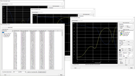

Network Parameter Analysis
Network Parameter analysis is running AC circuit simulation on the interconnect
network model to obtain network parameters between the ports in the model. A port is
assigned to each pin location. The analysis results for each frequency point include:
scattering (S)
admittance (Y)
impedance (Z)
parameter matrices
Prior to running analysis, you can change the analysis control parameters such
as the starting and ending frequency points, frequency sweep type, and number of
frequency points for the sweep type.

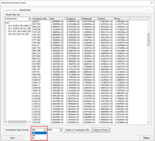

Upon completion of the analysis, the S-parameter magnitude values among ports are
initially displayed in the network parameter viewer. You can change the port pair
selections and change the value type to decibel, phase, real number, or imaginary
number. You can choose the network parameter type for the display among S-parameter,
Y-parameter, and Z-parameter. Many display and measurement options are available in
the network parameter viewer. Result Data menu is used to list the network parameter
values in a table format. The network parameter values can be saved in a Touchstone
format file. Additionally, they can be viewed in MS Excel. Figure 6.

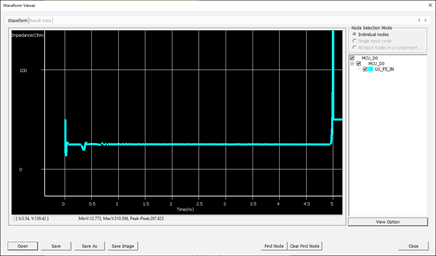

TDR Analysis
TDR analysis is running transient circuit simulation on the network model to obtain
reflected waveform to generate the impedance waveform (TDR) seen from the driver.
TDR analysis only considers the wave reflected to the driver stage. Multiple
reflection is not considered. Figure 7.
