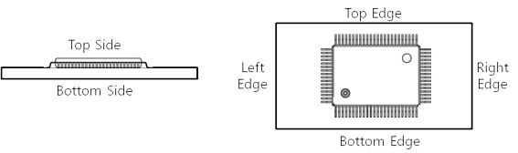

Board Sides

Board Edges

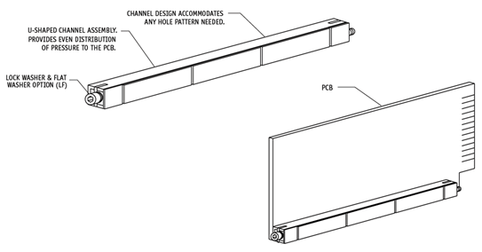

Conduction boundary condition: Wedge lock is a mechanical component to fix the electronic module assembled electronic device by using sliding mode. It protects the electronic module from external vibration and transfers the electronic module’s heat to outside. If specified edge has wedge-lock heat-sink, define them.
Figure 4.
Wedge lock resistance (K.mm/W): Specify resistance of wedge-lock.

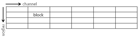

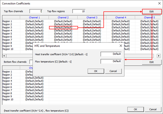

Convection Coefficients
If you want to assign different convection condition for some area, define them after dividing PCB into block. After making block, users can assign convection coefficient into block with values, flow temperature and heat transfer coefficient.
Figure 5.
Select each block and click Edit to change each block’s value.
Figure 6.

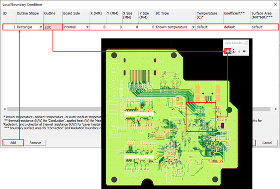

Local Boundary Condition
For certain regions, if you want to assign special boundary condition on PCB design, use this menu. The Following image Figure 7 shows the way to make a region on PCB design.
Figure 7.
After defining a region, define local boundary conditions. The Boundary Conditions of several parameters are filled in one line.
Figure 8.
ID: Boundary condition’s index ID starting from 1
Outline Shape: User-defined shape. User can input local region with two geometries, Rectangle or Circle.
Outline: Button menu to draw local boundary
Board Side: Board side on which local boundary placed.
X (Size) / Y (Size): Local boundary’s size
BC Type: You can select one of boundary condition type among Known Temperature, Conduction, Heat Source, Convection, Radiation and Layer Heatsink. Depending on the choice of this value, following columns’ values may change their meanings.
The following table shows other columns’ values depending on BC Type.
BC Type Temperature Coefficient Surface Area
Known Temperature Known Temperature NA NA
Conduction Outer Medium Temperature Thermal Resistance (K/W) NA
Heat Source NA Applied Heat (W) NA
Convection Ambient Temperature Heat Transfer Coefficient (W/m^2.K) Boundary Surface Area
Radiation Outer Medium Temperature Effective Radiation Emissivity Boundary Surface Area
Thermal PAD NA Thickness (mm) NA
  • Temperature: refers to above description.
  • Coefficient: refers to above description.
  • Surface Area: refers to above description.

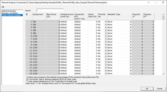

Comp Thermal Condition
At this menu, you can define different analysis conditions for references on PCB design. Each line contains a component’s parameters.
Figure 9.
ID: References’ index ID.
Component: Identifier on PCB design (Reference Name).
Max Power (W): Maximum power assign in UPF library (Not editable value).
Analysis Power Level (%): You can change this value depending on the components’ power usages. Default is 80% of assigned power at UPF file in part library.
Convection HTC (W/m^2.K): At component’s top side, if there is special conduction condition, specify the component top side convection heat transfer coefficient.
Glue Area (%): At component’s top side, if there is glued structure, define them with ration regarding to component top side area.
Thermal Via: If there are used thermal via under component bottom side, check Yes.
Heatsink Type: Choose the component heat-sink type among Convection, Conduction-to-Outside and Conduction-to-Board. Depending on the choice of this value, following columns’ values may change their meanings.
Heatsink Type Property A* Property B*
Convection Surface Area increased by Heat-sink (%) NA
Conduction-to-Outside Thermal Resistance (K/W) Outer Medium Temperature (C)
Conduction-to-Board Thermal Resistance (K/W) NA
  • Property A*: refer to above description.
  • Property B**: refer to above description.
