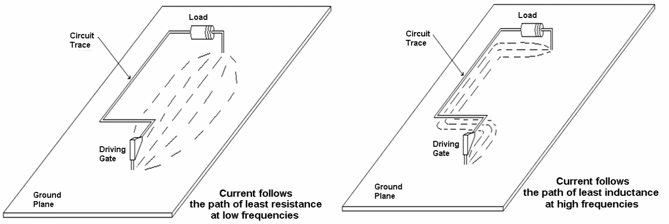

When a current flows on a signal trace, there is always a return loop. If some current goes out to somewhere, it will always come back to source. The path of returning current is Return Path. Return path is formed differently depends on frequency. At low frequencies, the current follows the path of least resistance. At high frequencies, current follows the path of least inductance and it stays tightly bunched near signal trace.

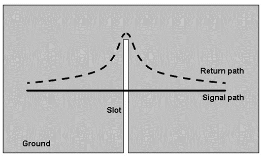

Return path is the shortest when signal trace is tightly shielded by solid ground plane below or by coplanar ground. However, any discontinuities, such as slots, gaps, holes and split planes, along the shortest return path makes the current to go around the discontinuities.
At high frequency, longer return path leads to an unexpected ground/power bounce and increases a possibility of EMI.
