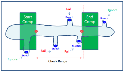

- End Type: Define the end point test condition.
- Don’t care: Check between start pin and end pin only. Do not check
beyond end pin.
Figure 1. - M-GND: Check between start pin and end pin. Check if end point is
directly connected to M-GND.

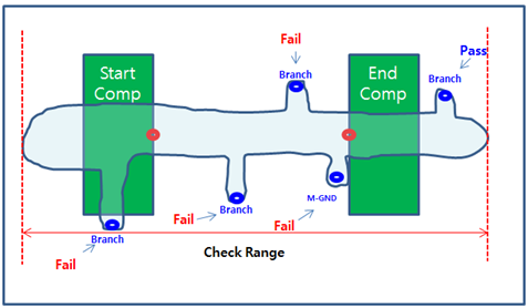

Figure 2. - Branch: Check between start pin and end pin, and check beyond start
pin and end pin. If branch exist beyond start pin, it reports fail.
If branch exist beyond end pin, ignore it.
Figure 3.
