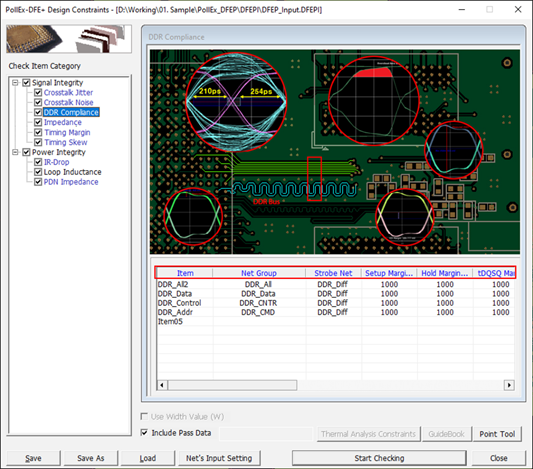

Figure 1. DDR Compliance
- Item: Sub item name. User can enter arbitrary name.
- Net Group: Select target net groups to be tested. Allow multiple net groups.
- Strobe Net: Option to select target strobe net groups to be tested. (Clock, DQS, etc.)
- Setup Margin(pS): Enter required minimum setup time margin value in pS unit.
- Hold Margin(pS): Enter required minimum hold time margin value in pS unit.
- tDQSQ Margin(pS): Enter required maximum tDQSQ time margin value in pS unit.
- tQH Margin(pS): Enter required maximum tQH time margin value in pS unit.
- Overshoot Margin(mV): Enter allowable maximum overshoot voltage in mV unit.
- Overshoot Area Margin(V-nS): Enter allowable maximum overshoot area amount in V-nS unit.
- Undershoot Margin(mV): Enter allowable maximum undershoot voltage in mV unit.
- Undershoot Area Margin(V-nS): Enter allowable maximum undershoot area amount in V-nS unit.
- VSEH Margin(mV): Enter allowable minimum single-ended high level voltage of differential signal in mV unit.
- VSEL Margin(mV): Enter allowable maximum single-ended low level voltage of differential signal in mV unit.
- VIX Margin(mV): Enter maximum allowable crosspoint deviation value of differential signal. (DDR3)
- VID Margin(mV): Enter maximum allowable crosspoint deviation value of differential signal. (DDR2)
- Analysis option: Upon double-clicking this field, the Automatic DDR Bus Analysis dialog will be displayed. This dialog is used for automatically extracting all data strobe, data, clock, address, command, and control line nets of DDR (double data rate) memory interfaces including DDR (DDDR1), DDR2, DDR3 and DDR4, automatically constructing data line, address line, command line, and control line analysis models, performing eye diagram analyses on all of the models, and calculating the setup and hold timing margins of all data, address, command, and control line signals.

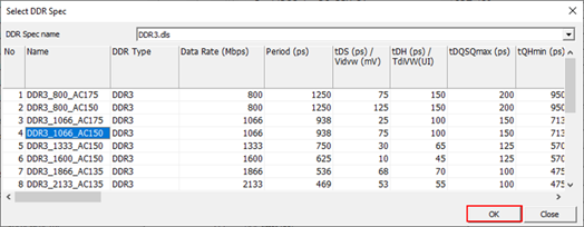

- Import DDR Spec: In order to analyze DDR timing, user has to enter every
timing parameter manually. But upon clicking Import DDR Spec button, users
can automatically bring in a DDR timing specification to use among available
DDR timing tables.
Figure 2. - DDR Spec Generator: Users can also generate a new DDR timing specification into the exist DDR timing tables.
