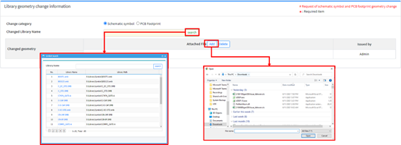

Change Library Geometry information.
Click Search and find the library to be
changed.
Attach the geometry information file to be changed. (Datasheet, and so
on)

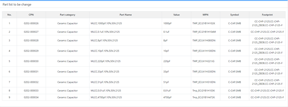

Once a library geometry is selected, UDE displays the parts list which
use the library geometry. Figure 2.
Add comment explaining the reason for changing the library and attach the
related file.

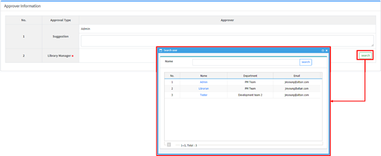

Select an approver for changing the library geometry.
Figure 3.

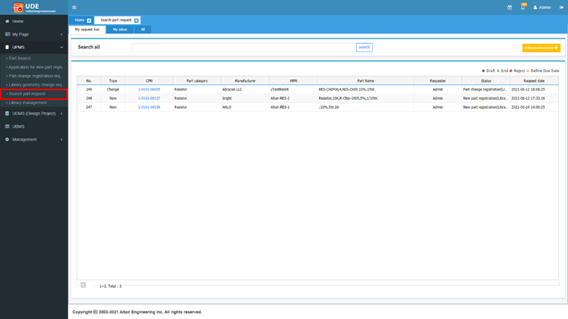

Once the library geometry change is requested, you can check it in the
waiting list of My request box. Figure 4.
