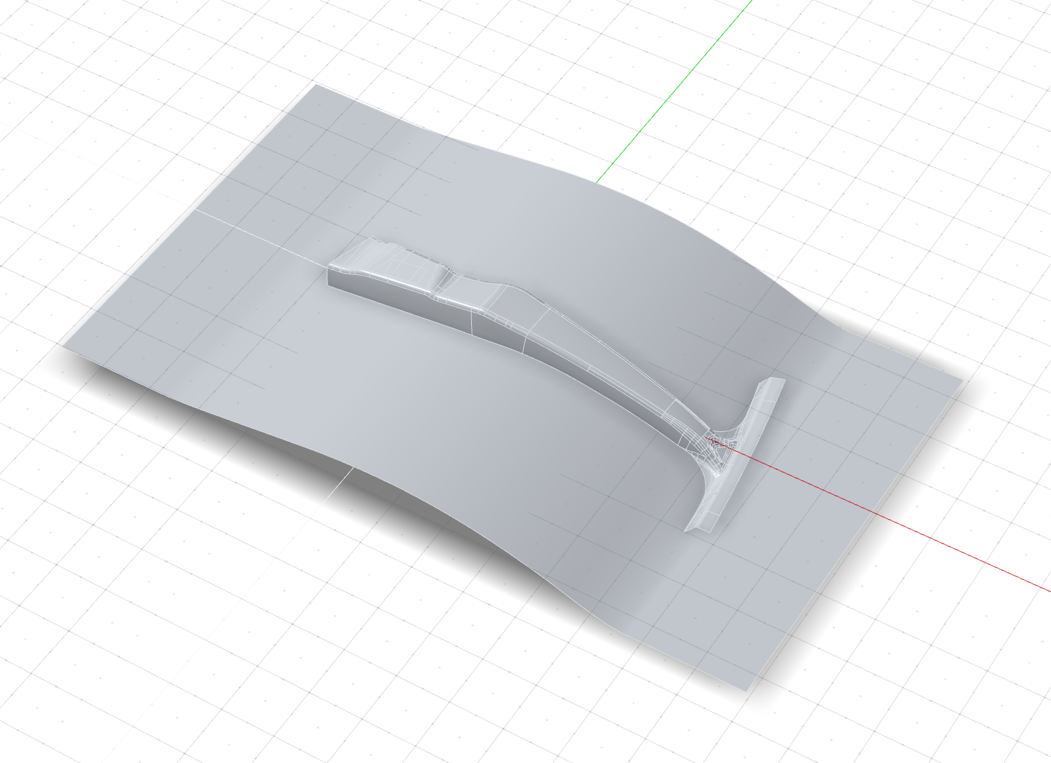

Define the Part

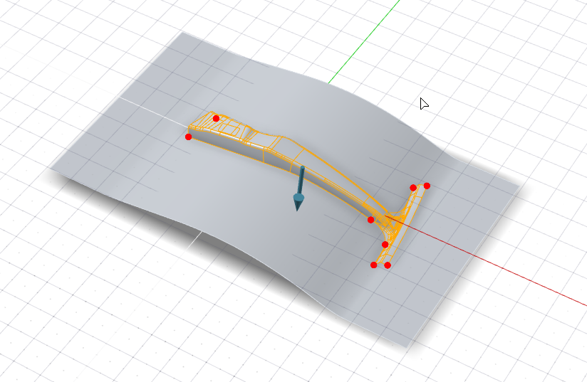

Select a part and define the thickness and position.

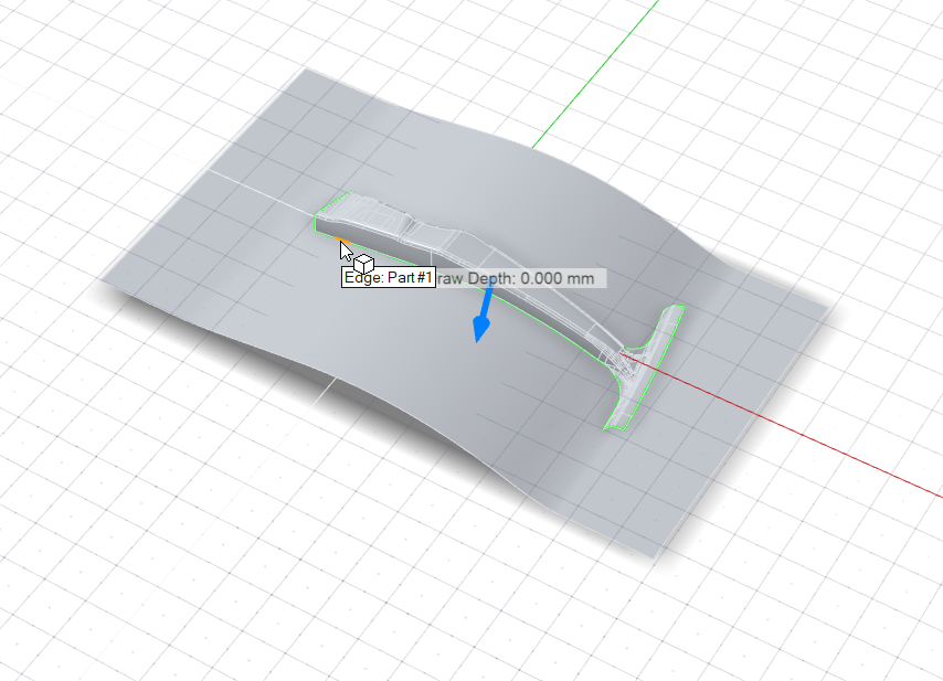

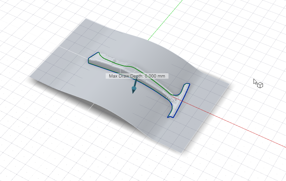

Set the Draw Direction

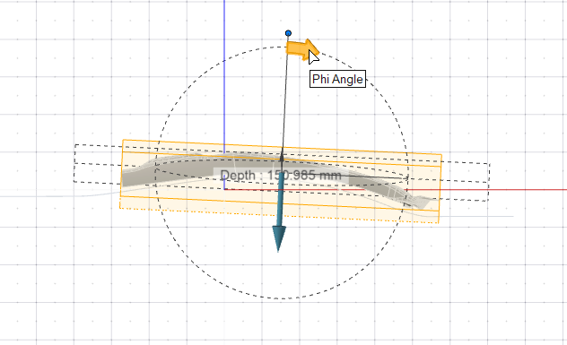

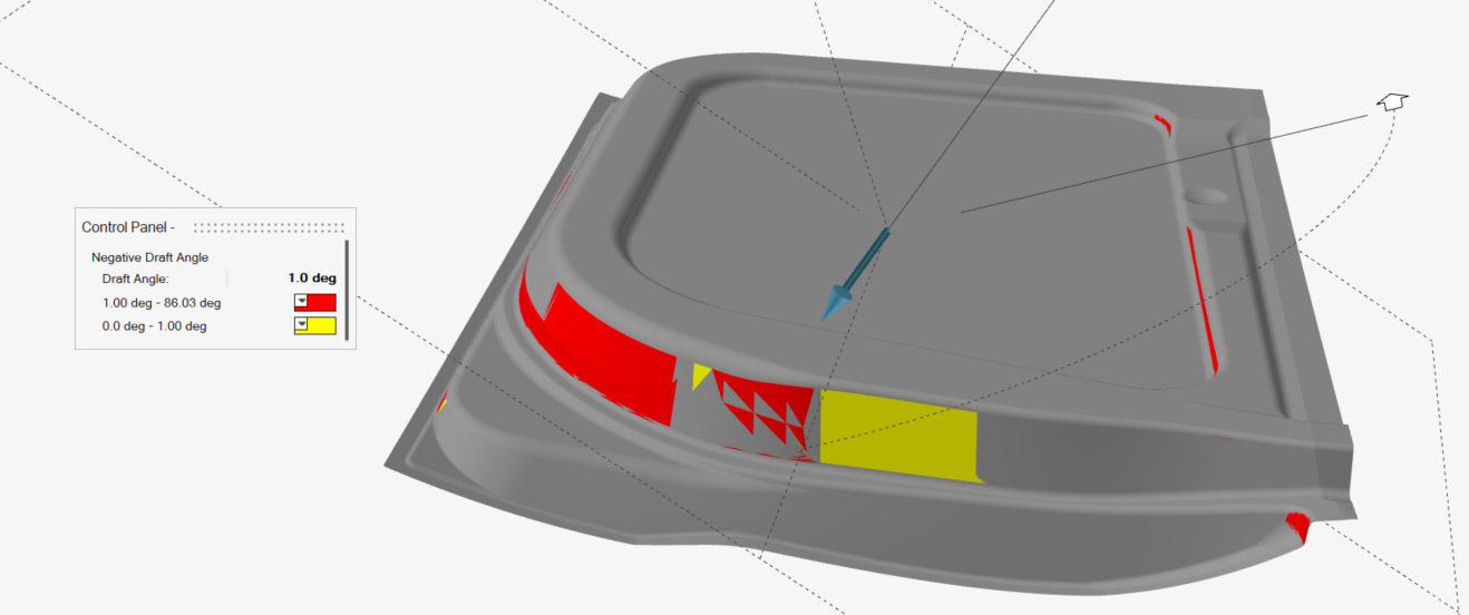

Adjust the draw direction to minimize the depth and avoid negative drafts with the help of the Depth Box and Draft Analysis.
Click the Draw Direction icon.
To display the draw depth, in the guide bar, select Depth
Box.
To display severe negative drafts in red and marginal negative drafts in
yellow, select Draft Analysis.

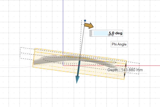

Set the draw direction:
Click the Phi Angle arrow.
Enter an angle of 5.0 deg.

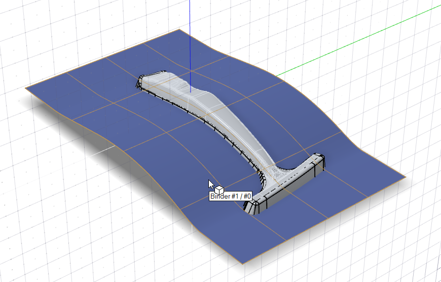

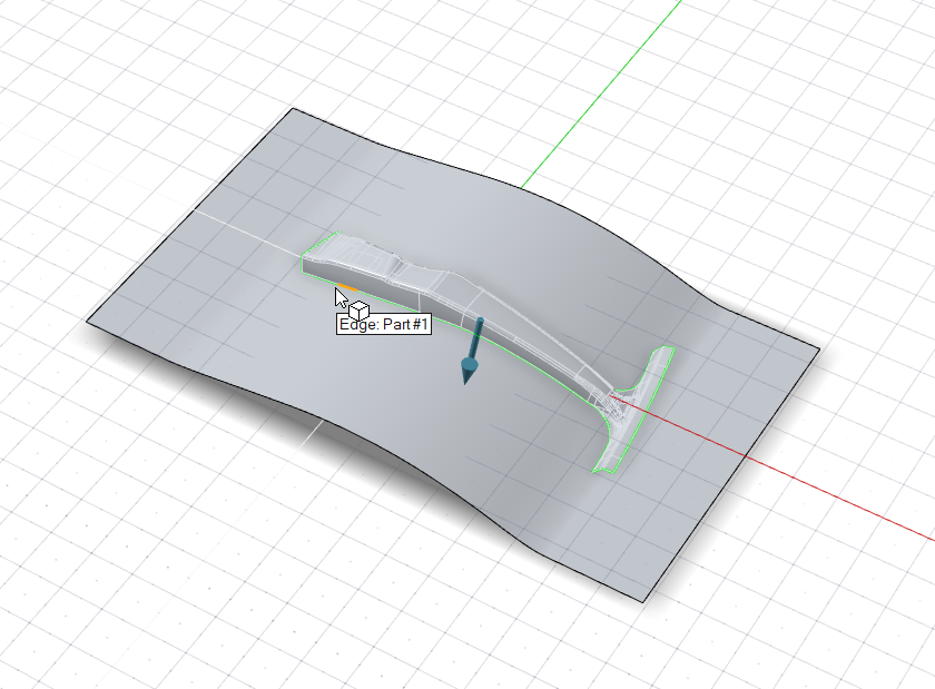

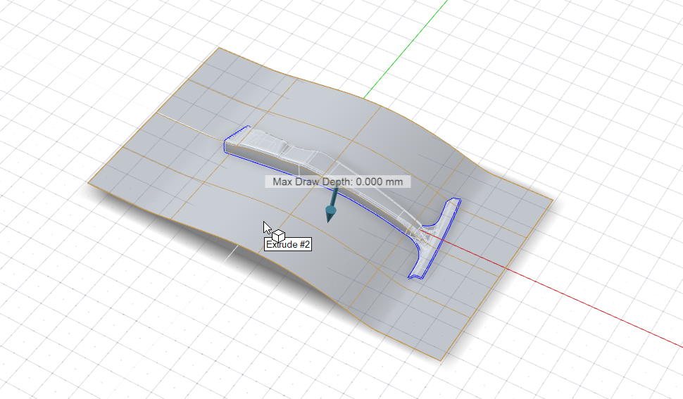

Create the Binder
Define a binder for the draw die. In this tutorial, we'll assign an existing surface as the binder.

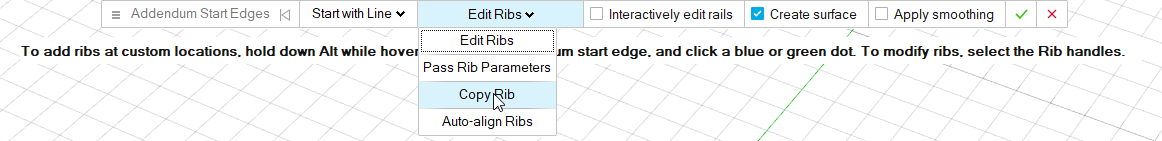

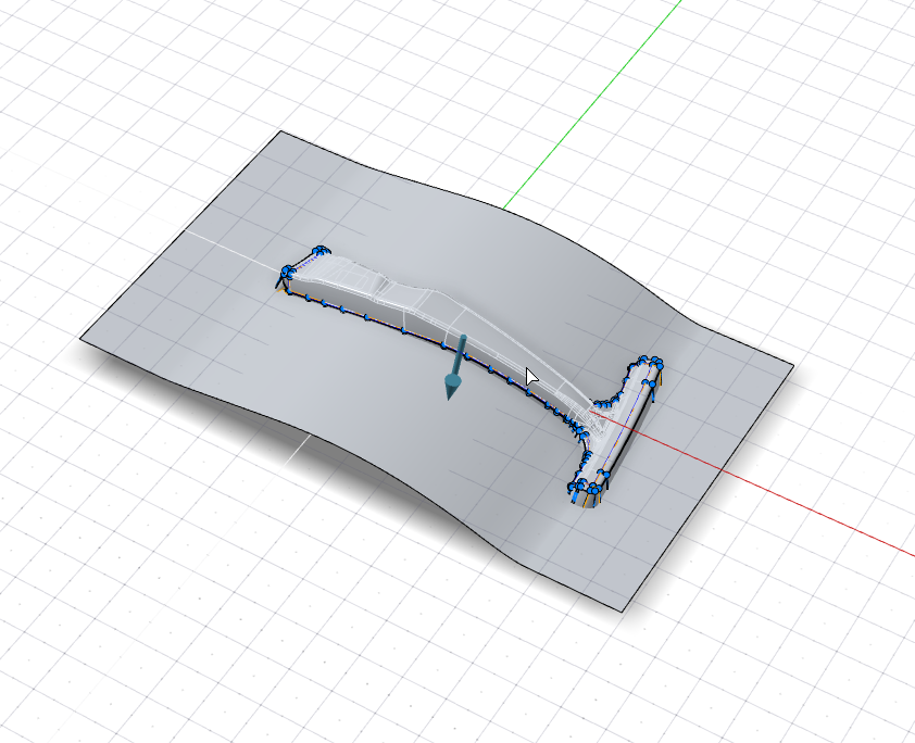

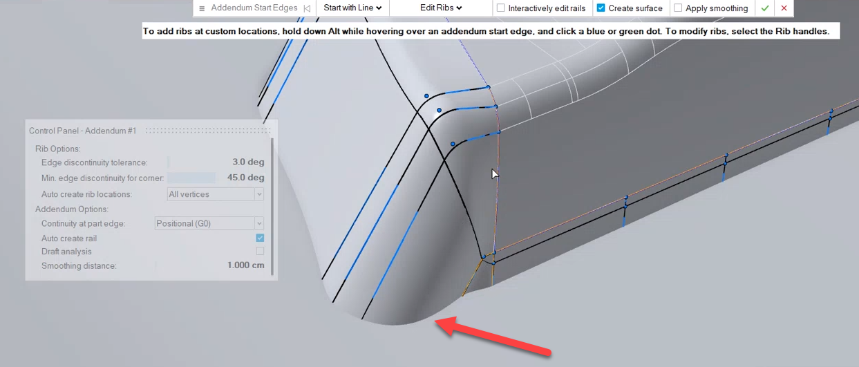

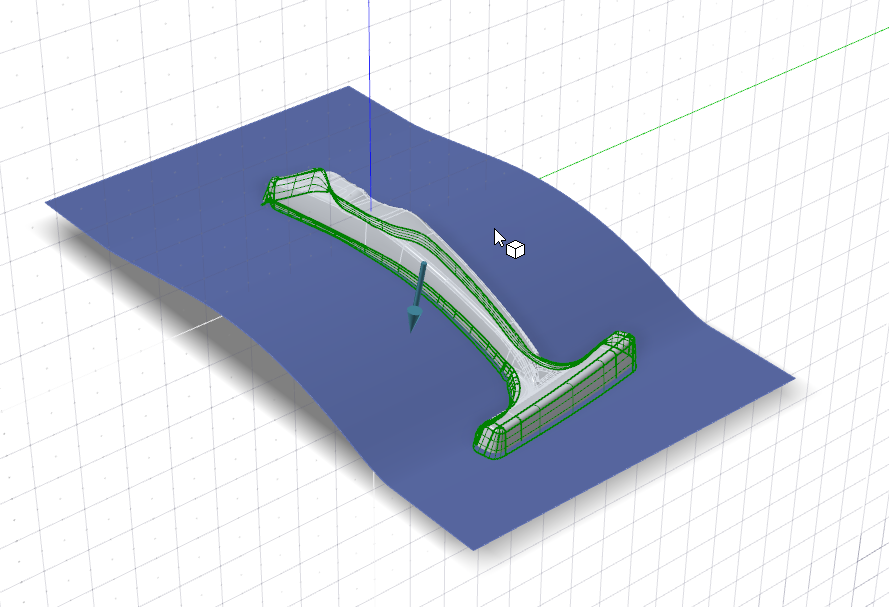

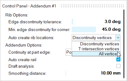

Create the Addendum

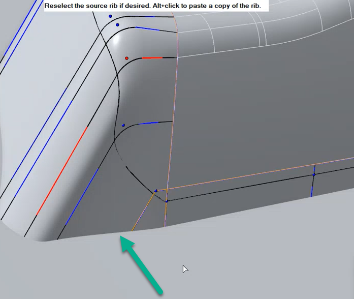

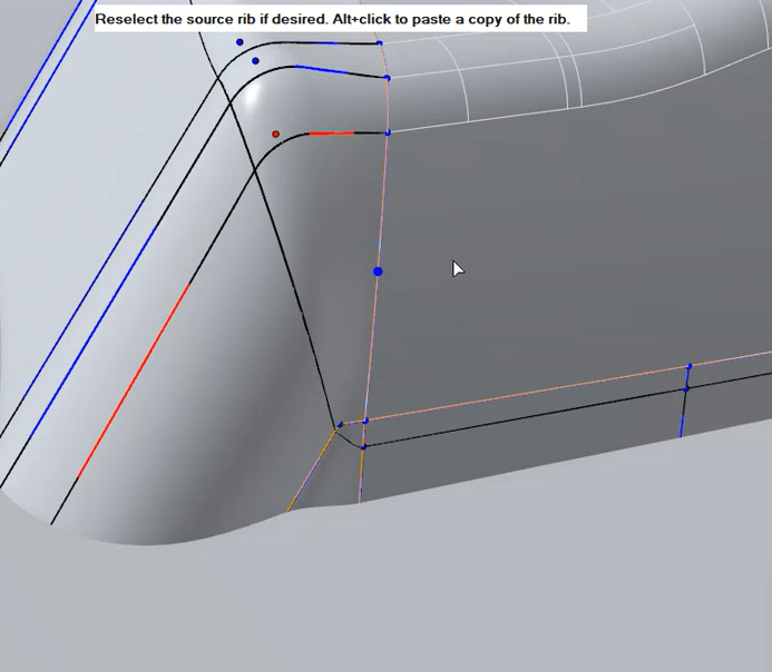

After creating the addendum, we'll tweak the shape by copying a rib.

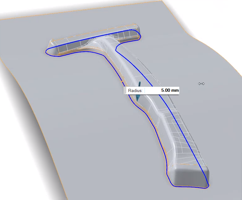

Finalize the Draw Die
Finalize the die by creating a fillet along the edge of the binder.
