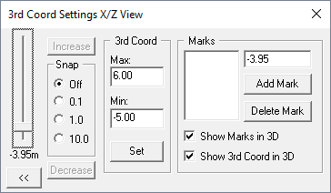

Open the dialog to modify the cut plane using one of the following
workflows:
- On the View toolbar, click the
3rd Coordinate Settings icon. - On the Display menu, click
Show 3rd Coord Dialog.
Figure 1. The 3rd Coord Settings X/Y View dialog.Note: The current active window determines the cut plane that can be modified.
Move the slider and observe how the cross-section and 3D view change.

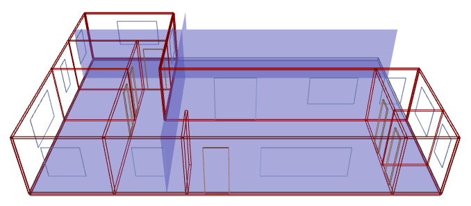

Figure 2. The XZ cut plane at -3.95 m.

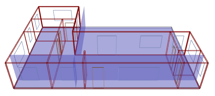

Figure 3. The XZ cut plane at 3.90 m. -
