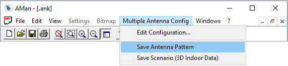

MASC project settings can be saved, loaded and exported.
The MASC project settings are saved with the menu and loaded with the .
The MASC project (.ank) and the resulting antenna pattern are different files. In the MASC project, only the configuration is saved and described.
Figure 1. Saving antenna patterns.
In the menu, Multiple Antenna Config the item Save Scenario (3D Indoor Data) is also available. With this item, the generated objects (for example, masts, walls, arms, radomes) are exported in WallMan data format to be further processed and analyzed with WallMan. This might be interesting when the material properties must be selected or if further analysis with ray-tracing tools is required.
