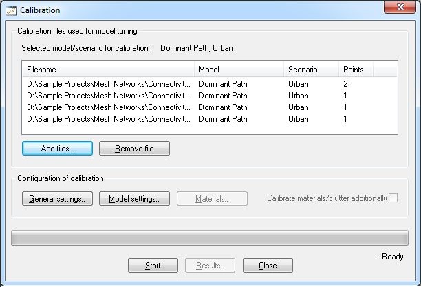

The calibration tool can be used to tune wave propagation models based on calibration files obtained during wave propagation predictions. The calibration tools can be started by selecting Computation menu. One or more calibration files can be added to the list.
from the
- Calibration Files Used for Model Tuning
- Files can be added by clicking on Add files or deleted by clicking on Remove file.
- Configuration of Calibration
