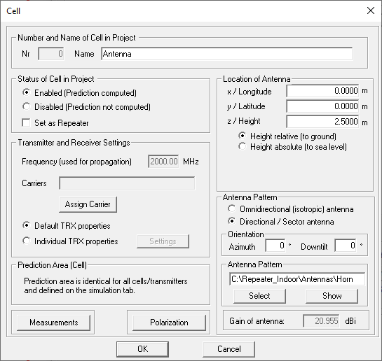

Figure 1. The Cell dialog to adjust directional transmitter settings.
Number (Nr)
The number of transmitters is the internal ID and used by ProMan to separate the transmitters of one project. This is not relevant for the project settings.
Name
The name of the antenna/transmitter is important because it is added to the basic output file name. If the basic output file name is xy and the antenna name is TRX 1 the results will be saved in files xy_TRX 1.*. Concerning the name of the antenna the following rules must be considered:
  • Only characters can be used which are allowed in file names.
  • The name must be unique within the project to avoid collisions with other transmitters.
Status of Cell / Transmitter in Project
The transmitter can be enabled or disabled. Only enabled transmitters will be computed. If no modifications were made, the transmitter can be disabled to save computation time and so only the modified (and enabled) transmitters
The transmitter can be defined as a repeater by selecting the Set as Repeater check box. Upon selecting this check box, a pull-down menu appears to define the mode of operation. Two modes of operation are available for a repeater, Reconfigurable Mode and Transparent Mode.
  • A reconfigurable repeater will retransmit the signal it receives from the gateway after amplifying it to a certain user-defined power. Its transmission may be at a different frequency, but doesn’t have to be.
  • A transparent repeater will retransmit the signal it receives from the gateway after amplifying it by a certain user-defined gain. Its transmission will be at the same frequency.
A few rules apply:
  • A repeater has to be a member of a site that includes at least one transmitter that is not a repeater. This can be the Gateway.
  • In network planning, for the calculation of interference, the signal from a repeater always belongs to the same Signal Group as the signal from the Gateway. Hence, the repeater will not cause undue interference with the gateway and other repeaters in the same site.
are computed when starting the computation. The transmitter status can also be changed via the project toolbar using the icon and by clicking with the mouse on the transmitter. The individual cells within the project can be included or excluded from the network optimization process.
Transmitter Settings
The frequency is defined in this section as well as the output power (which is required for the determination of the received power or field strength). The output power can either be defined in Watt or dBm. And the output power can be defined as one of the following:
  • the output power of the PA (power amplifier)
  • as effective radiated power (ERP) - for example, relative to dipole antenna
  • equivalent isotropic radiated power (EIRP) - for example, relative to an isotropic antenna
If G is the gain of the antenna (in dBi), the values can be determined via the following equation:
P EIRP = P ERP +2.1 dB=  P output power +G

Location of antenna
Location coordinates of the antenna. The same coordinate system as used for the database must be used. The coordinates can be entered in the dialog or the transmitter can also be moved/placed with the mouse via the menu Project > Transmitter > Transmitter: Move or via the toolbar using the icon.
Type of antenna
A selection between isotropic antenna and directional /sector antenna. An antenna pattern must only be defined if the sector antenna is enabled. If omnidirectional antennas should be considered, an isotropic antenna can be selected, and the gain of the omnidirectional antenna can be added to the EIRP value of the output power.
Tip: As soon as the horizontal orientation is changed with the mouse via the corresponding function in the Project > Transmitter > Transmitter: Azimuth menu, sector antenna is set. If sector antenna is chosen, an antenna file has to be specified.
Antenna Pattern
If a sector antenna is selected (instead of isotropic/omnidirectional), a 3D antenna pattern file must be selected. A relative or absolute path can be added. The antenna pattern file can either be in a binary format (.apb) or ASCII format (.apa, .msi, .pln or .ffe)1.
Vertical Orientation
You can specify a mechanical down-tilt (positive values) or a mechanical up tilt (negative values). An electrical down tilt must be considered in the selected antenna pattern (the pattern is different depending on the electrical down tilt).
Horizontal Orientation
It can be specified more easily with the option Change horizontal orientation in the Edit -> Transmitter menu. The direction of the y-axis is 0 degree, the orientation is clockwise (North over East).
Switch between omnidirectional and directional antennas and changing the horizontal orientation is done with the function Project > Transmitter > Transmitter: Azimuth or with the icon in the project toolbar.
  • Click on a transmitter and then draw a line in the desired direction while holding the mouse button. Then release the mouse button.
  • To switch back to an omnidirectional antenna, click on the transmitter and immediately release the mouse button.
    Tip: If you have defined a directional antenna you must specify an antenna file using the function Project > Edit Project Parameters and switch or with the icon in the project toolbar.
