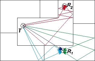

Figure 1. Principle of ray optical models
As smaller wavelengths (higher frequencies) are considered, the wave propagation becomes similar to the propagation of light. Therefore a radio ray is assumed to propagate along a straight line influenced only by refraction, reflection, diffraction or scattering which is the concept of geometrical optics (GO). The criterion taken into account for this modeling approach is that the wavelength should be much smaller in comparison to the extension of the considered obstacles, for example, the walls of a building. At the frequencies used for mobile communication networks this criterion is also inside buildings sufficiently fulfilled.

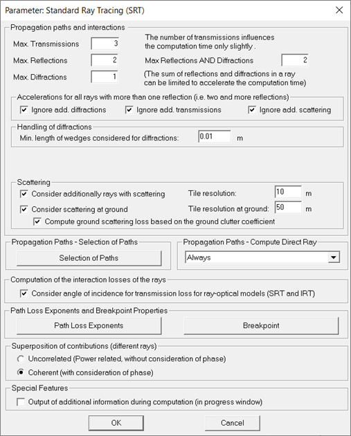

Figure 2. The Parameter: Standard Ray Tracing (SRT) dialog. - Propagation Paths and Interactions
- The Propagation paths and interactions group
allows to specify the number of interactions that should be considered
for the determination of ray paths between transmitter and receiver
including the maximum number of reflections, diffractions and
scattering. To accelerate the prediction, additional diffractions and
transmissions can be ignored for all rays with more than one reflection.
The minimum length of wedges where diffractions can occur can be
specified in meters. In case the simulation database contains ground
objects (topography in vector format), interaction at those objects can
optionally be considered. Diffuse scattering in indoor scenarios can
play an important role, especially for determining the actual temporal
and angular dispersion of the radio channel.
The WinProp SRT model was extended to consider the scattering on building walls and other objects. For this purpose the scattering can be activated in the model settings by enabling the option “Consider additionally rays with scattering”. As the scattering increases the overall number of rays significantly, there is a limitation of one scattering per ray. Furthermore, the surface roughnesses of the corresponding materials need to be defined (in WallMan and / or ProMan).
For the scattering in the SRT model, tiles as defined in the dialog are considered. The scattered contribution is weighted with the size of the scattering area (tile). Accordingly the resulting scattered power from the whole object is for large distances independent of the tile size. For small distances there is an impact due to the modified scattering angles which depend on the tile size.
Optionally, scattering at pixel and vector ground can be considered. As described under Project Settings, a topography database can be included in an “ indoor” scenario. “Indoor” in WinProp has grown to denote any scenario with more geometrical freedom than urban and rural scenarios. The tile size for ground scattering can be chosen different from that on buildings.
The option Compute ground scattering loss based on the ground clutter coefficient activates the constant-γ model for ground clutter, in which the ground’s radar cross section per unit area σ0 is modeled as
(1) where ψ is the grazing angle relative to the surface and γ is a parameter describing the scattering property of the terrain surface.
For sea clutter, γ depends on Beaufort wind scale KB and radar wavelength:
(2) The reflectivity of land clutter is much more difficult to characterize than that of the sea. The constant-γ model is applied with values of γ for different terrain types as shown in Table 1.
Table 1. The reflectivity of land clutter. Surface Description Mean Reflectivity Coefficient γ [dB] Mountains -5 Roughness ≥ 50 m. Urban -5 Terrain type is building. Wooded hills -10 10 m < Roughness < 50 m, and terrain type is light or dark forest. Rolling hills -12 10 m < Roughness < 50 m, and terrain type is not light or dark forest. Farmland, Desert -15 Roughness ≤ 10m, and small-scale average roughness > 1.5 m. Flatland -20 Roughness ≤ 10 m, and small-scale average roughness between 0.5 m and 1.5 m. Smooth surface -25 Roughness ≤ 10m, and small-scale average roughness ≤ 0.5 m. WinProp will obtain the value of γ from the empirical reflection loss of the material, as defined in the project or in the material catalogue. If you know the value of γ from measurements or literature, use it when specifying the empirical loss of the particular ground material.
If the constant-γ model is not activated, then scattering at the ground will be calculated by the same algorithm as scattering at building walls and other objects, using the specified surface roughness and the frequency.

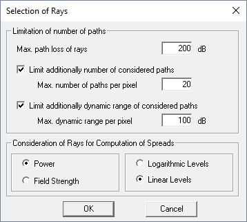

- Propagation Paths - Selection of Paths
- This option allows the limitation of the number of paths per pixel with the following options: maximum path loss of rays, maximum number of paths or dynamic range of paths.
- Propagation Paths - Direct Ray
- The direct ray can be computed always, despite the number of transmissions specified in the first section.
- Computation of interaction losses of the rays
- For the computation of the rays, not only the free space loss has to be considered but also the loss due to the transmissions, reflections and (multiple) diffraction. This is either done using a physical deterministic model or using an empirical model similar to the method for the intelligent ray-tracing (IRT). Optionally the interaction losses of the rays can be determined considering the angle of incidence for the calculation of the transmission loss
- Path Loss Exponent for ray-optical models
- Exponent for distance-dependent path loss.
- Superposition of contributions (different rays)
- Superposition of contributions of different rays can be done either incoherent (without consideration of the phases) or coherent (with consideration of the phases).
- Special Features
- Additional information can be displayed in the progress window during
the simulation if desired.Note: Parameters defined in the dialog apply for both ray-tracing models (for the standard ray-tracing model and the intelligent ray-tracing model).
