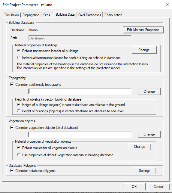

Figure 1. The Edit project parameter dialog, Building data tab.
- Building database
- You can change the database file path only.
- Material properties of buildings
- The individual material properties of the buildings (as defined in the
building database) can be used by the prediction models when the prediction
is computed or default values for all buildings can be used. This can be
selected on the Database tab of the Edit
project parameters dialog.
The COST model does not consider the material properties of the buildings. The consideration of the material properties in the propagation models and their influence on the prediction results is explained together with the propagation models, because they are used in a different way (for example the COST Walfisch-Ikegami model does not consider the material properties of the buildings at all, therefore these fields are not enabled when a COST database is loaded which allows only COST predictions).

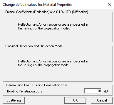

If the individual properties are not defined in the database or if the user does not want to use the material properties defined in the database, default values can be used by enabling Default transmission loss for all buildings. In this case, all buildings are assigned the same building penetration loss independent of the definitions in the database (individually defined properties are not taken into account, for all buildings the same material properties are used). The default value can be changed by using the Change button.
Ray optical propagation models, such as standard ray-tracing (SRT) and intelligent ray-tracing (IRT) use all material parameters listed in the dialog for Fresnel coefficients and GTD / UTD or the empirical transmission, reflection and diffraction model, respectively, depending on the computation mode of signal level. Semi-deterministic and empirical prediction models only use parameters for Fresnel coefficients or the values for the transmission loss, respectively, depending on the computation mode of signal level.
- Topography
- Terrain elevation data can be considered additionally. The corresponding
database file can be selected via the Change button.
After that, the heights of the buildings contained in the vector database
have to be specified to be either relative to the ground level (terrain
elevation data) or absolute to sea level.Note: This option is not available if a pre-processed database is used. In this case topography data can be considered optionally during pre-processing and is already included in the building vector database then.
- Vegetation Objects
- Vegetation data can be considered optionally. Vegetation blocks can be
included either as vector objects or based on a pixel database, which can be
specified additionally. If no vector vegetation objects are already
contained in the database, a pixel database describing vegetation can be
specified using the Change button.

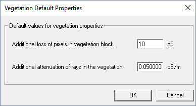

For both vector and pixel based vegetation objects material properties can be specified. If pixel based vegetation objects are used or if the user does not want to use the properties defined for vegetation objects in the vector database, new values can be used by clicking Default values. In this case, all vegetation blocks are assigned the same values, independent of possible definitions in the vector database. Individually defined properties are not taken into account for vector based vegetation blocks, for all vegetation objects the same material properties are used. The default values can be changed by using the Change button. After clicking on the button, the dialog for the definition of the vegetation properties appears.

- Database polygons
- To manage the database areas, select the Consider database polygons check box. For more information refer to Reduce Computation Time for Large Databases.
