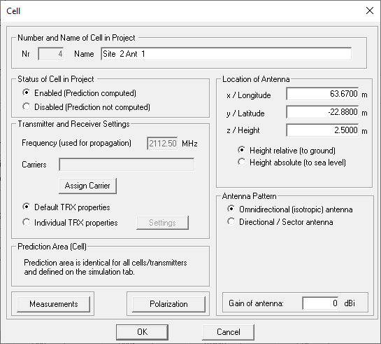

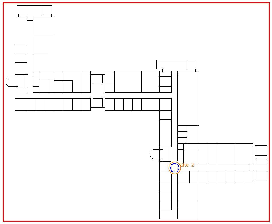

Define the second site, place the second omnidirectional antenna at this location, and assign a carrier. The antenna is placed at a height of 2.5 m above ground.
Figure 1. Location of the second antenna site.
