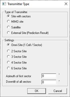

Specify the transmitter type and settings using one of the following
workflows:
- On the Project menu, click Sites > Site: New.
- On the Project toolbar, click the
Set Site icon.
The Transmitter Type dialog is displayed.
Figure 1. The Transmitter Type dialog. - Under Settings, click 3 Sector Site.
Click OK to close the Transmitter
Type dialog.

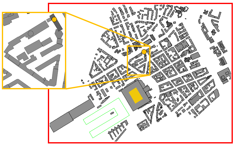

In the 2D view, the mouse cursor is displayed as a circle to indicate that the Set site tool is enabled.
Click near the point (indicated by an orange circle) in Figure 2.

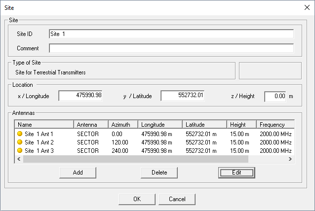

Figure 2. Place the first antenna site at the location of the orange dot.Note: The exact coordinates are not important for this example, but the above location is used in the steps that follow.The Site dialog is displayed.
Figure 3. The Site dialog. - Under Location, in the z/Height field, enter a value of 135.84 m.
On the Site dialog, click on Site 1 Antenna
1 to select and click Edit.

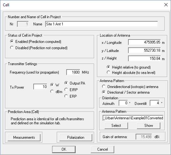

The Cell dialog is displayed for antenna 1.
- Under Transmitter Settings, in the Frequency (used for propagation) field, enter a value of 1800 MHz.
- Under Location of Antenna, in the z / Height field, enter a value of 150.84 m.
- Under Antenna Pattern, click Directional / Sector antenna.
- Under Orientation, in the Downtilt field, enter a value of 4°.
- Under Antenna Pattern, click Select to browse to the file farfield_gain_3d.ffe.
Click OK to close the Cell
dialog.
Figure 4. The Cell dialog for antenna 1. - Repeat Step 6 to Step 12 to define antenna 2.

- Click OK to close the Site dialog.
