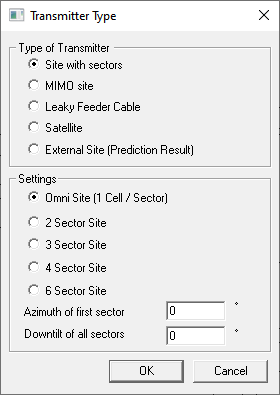

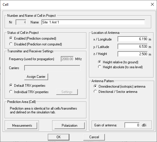

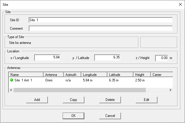

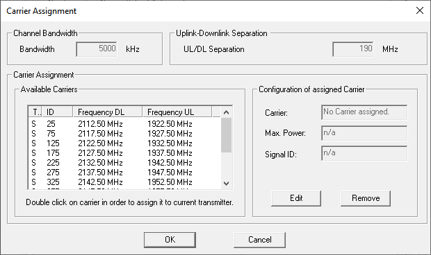

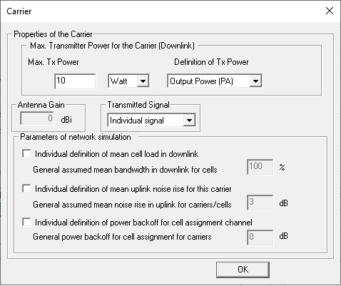

Define the first site, place the first omnidirectional antenna at this location, and assign a carrier. The antenna is placed at a height of 2.5 m above ground.
Figure 1. Location of the first antenna site.
