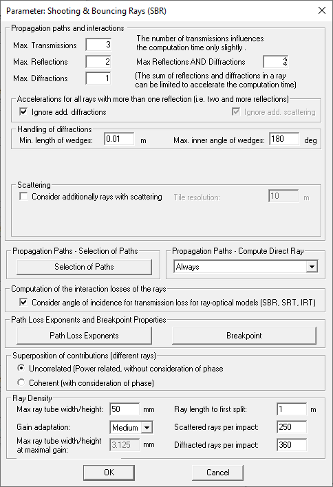

Figure 2. The Parameter: Shooting & Bouncing Rays (SBR) dialog. - Propagation Paths and Interactions
The Propagation paths and interactions group allows to specify the number of interactions that should be considered for the determination of ray paths between transmitter and receiver including the maximum number of reflections, diffractions and scattering. To accelerate the prediction, additional diffractions and transmissions can be ignored for all rays with more than one reflection. The minimum length of wedges where diffractions can occur can be specified in meters. The maximum inner angle of wedges can be specified in degrees. When a curved surface is approximated by many triangles, those may form many wedges for which a calculation of diffraction is not needed. This option enables you to exclude such diffractions and save simulation time. In case the simulation database contains ground objects (topography in vector format), interaction at those objects can optionally be considered. Diffuse scattering in indoor scenarios can play an important role, especially for determining the actual temporal and angular dispersion of the radio channel.
The WinProp SBR model was extended to consider the scattering on building walls and other objects. For this purpose the scattering can be activated in the model settings by enabling the option “Consider additionally rays with scattering”. As the scattering increases the overall number of rays significantly, there is a limitation of one scattering per ray. Furthermore, the surface roughnesses of the corresponding materials need to be defined (in WallMan and / or ProMan).
For the scattering in the SRT model, tiles as defined in the dialog are considered. The scattered contribution is weighted with the size of the scattering area (tile). Accordingly the resulting scattered power from the whole object is for large distances independent of the tile size. For small distances there is an impact due to the modified scattering angles which depend on the tile size.

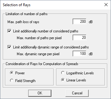

- Propagation Paths - Selection of Paths
This option allows the limitation of the number of paths per pixel with the following options: maximum path loss of rays, maximum number of paths or dynamic range of paths.
Figure 3. The Selection of Rays dialog.Tip: The computation time of SBR can be reduced significantly by reducing the Max. path loss of rays. Rays that encounter too much path loss will already be discarded during the computation.Note: To accelerate the computation, SBR will estimate the path loss of a ray based on empirical loss parameters. This way, rays which certainly are insignificant can be rejected early. The final signal level of a ray will still be predicted using the user-specified mode (based on Empirical Losses or on Fresnel Coefficients and GTD/UTD). - Propagation Paths - Direct Ray
- The direct ray can be computed always, despite the number of transmissions specified in the first section.

Since the SBR method starts by launching rays from the antenna, and, contrary to SRT, does not guarantee that every possible path will be found, the ray density parameters are important.
The Max ray tube side width/height, i.e., the width and the height of the small outgoing wave front of the ray tube, determines the minimum geometrical detail size that will affect the rays. Ray tubes are split to ensure that any ray tube cross section at an intersection with an object will not exceed the square of this value.
The Ray length to first split is the distance at which the splitting may commence. This length, in combination with the maximum tube side width and height, determines the number of rays that will be launched initially.
For instance, if this length is 1 m and the maximum tube width × height is 10×10 cm2, then 1257 rays will be launched to cover the 1-meter sphere with area 4π m2.

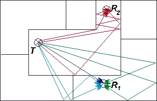

Figure 4. The concept of ray splitting to achieve proper ray density at interactions with objects.In Figure 4, the orange rays are the original rays. An intersection algorithm determines where interactions may occur. This algorithm ensures that any object larger than the minimum geometrical detail size (see above) will be found, even if it might be between orange rays in the figure. Geometry elements smaller than the maximum ray tube side width and height are not ignored. You can still get interactions at those, but the algorithm cannot guarantee that those are illuminated by at least a single ray.
At each interaction point the area of the ray cross section is computed. If this exceeds the user-set maximum the ray segment is repeated with multiple, split rays, to ensure that the maximum ray tube width and height are not exceeded at the interaction. The original ray (dotted in the Figure 4) is discarded and replaced by the split rays (green rays in Figure 4). The directions of the split rays are computed such that the ray cross sections cover the whole area of the original ray tube’s front.
Tip: Ray length to first split is ideally set such that it is at least the distance between the transmitter and the closest geometry (any geometry in the scenario, but avoid choosing a distance close to zero if the transmitter is mounted on an object).In a typical automotive-radar application, the ray length to first split may be between one and ten meters, and the number of rays launched may be between 1E5 and 1E6.
If the distance is set too large, the ray density close to the transmitter becomes unnecessarily high, and objects close to the transmitter, are hit by many more rays than needed, which slows down the computation. The distance to first split will be reduced automatically if needed to ensure that no more than 50 million rays be launched from the transmitter.
Tip: Max ray tube side width/height should always be smaller than the discretization of the result pixels to reduce the chance that a result pixel will not receive any rays.The Gain adaptation determines to what extend a higher ray density will be used in directions with higher antenna gain. Options are Off, Low, Medium, High.- Low
- If the antenna gain for a direction is higher than MaxGain - 1 * 6dB the density will be increased for that direction by a factor of 2 (side length).
- Medium
If the antenna gain for a direction is higher than MaxGain - 2 * 6dB the density will be increased for that direction by a factor of 2 (side length).
If the antenna gain for a direction is higher than MaxGain - 1 * 6dB the density will be increased for that direction by a factor of 4 (side length).
- High
If the antenna gain for a direction is higher than MaxGain - 3 * 6dB the density will be increased for that direction by a factor of 2 (side length).
If the antenna gain for a direction is higher than MaxGain - 2 * 6dB the density will be increased for that direction by a factor of 4 (side length).
If the antenna gain for a direction is higher than MaxGain - 1 * 6dB the density will be increased for that direction by a factor of 8 (side length).
Scattered rays per impact determines how many new rays are spawned at each scattering interaction. If the physics of the scattering predicts a lobe in a certain direction, then the density of new rays in that lobe will automatically be higher than in other directions.
Diffracted rays per impact determines how many new rays are created at each diffraction interaction.
