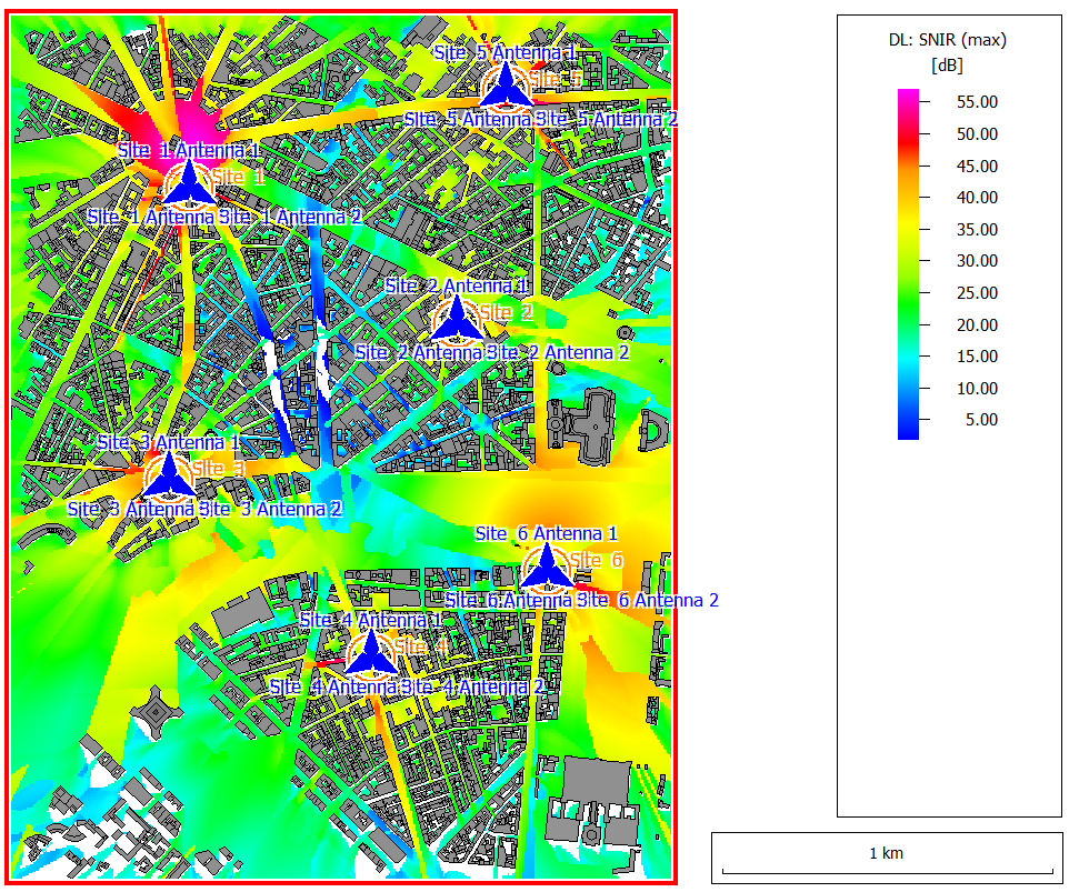

- Display the SNIR plot you wish to convert.
Figure 1. An example of a SNIR plot. - Click .

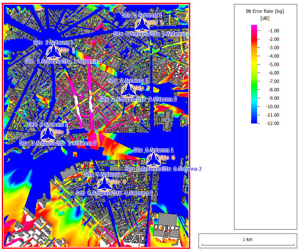

For instance, at a SNIR of 21 dB, the Bit Error Rate for this transmission mode is 10-6.5 ≈ 3.2×10-7. Since the BER curves depend on many parameters, you need to provide the table for the transmission mode of interest.
Figure 2. An example of a BER plot (converted from a SNIR plot).
