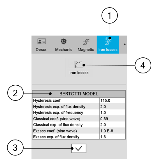

When creating a new material or when editing the properties of an existing one, a tab is dedicated to the magnetic data. In this tab, iron loss coefficients must be given.
| Definition of iron loss coefficients | |
| 1 | Category dedicated to iron losses. |
| 2 | Parameters defining the iron losses according to the model described above (Bertotti model). |
| 3 | Click “ok” button to validate the inputs |
| 4 | Click in the fitting icon in order to get an iron losses model from measured data. |

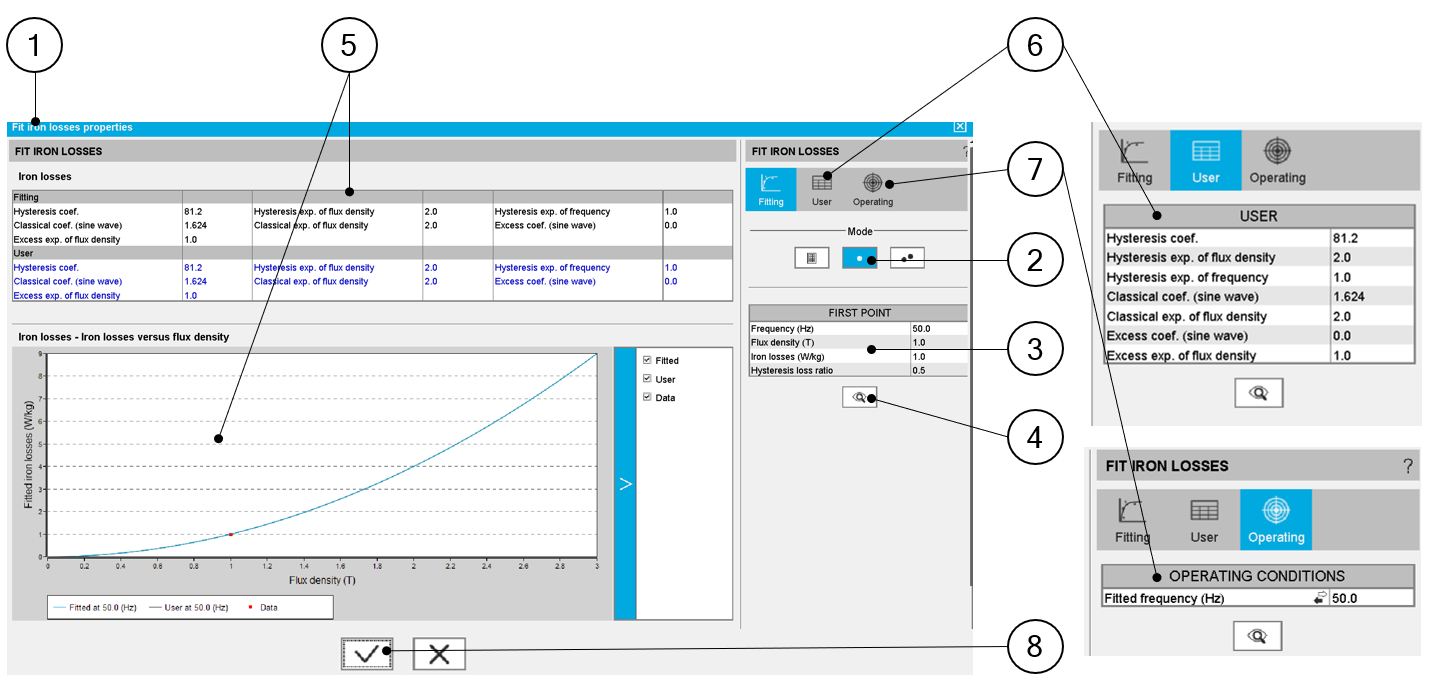

2.2 Case 1: From one measurement point
| Definition of iron loss coefficients – from one measurement point | |
| 1 | Dialog box dedicated to fit the iron loss parameters. Located in the “iron losses” category when visualizing or editing the material properties. |
| 2 | Choice of the method to find iron loss parameters (1 point in this example). |
| 3 | Measurement characteristics:
Note: Hysteresis loss ratio is the ratio between
the hysteresis losses and the total amount of iron losses.
| 4 | When input parameters characterizing the measurement point are defined, click the button Fit to run the optimization process. This process computes the set of iron loss parameters that allow targeting the considered measurement point. |
| 5 | The iron loss input parameters are deduced and displayed in the result table and the corresponding curve, Losses versus B (magnetic flux density) are displayed. |
| 6 |
The user can adjust one or all the parameters of the iron losses model. To do so user tab must be selected by clicking on its icon. The resulting modification is directly displayed in the output area. |
| 7 | It is possible to select a frequency to visualize the behavior of the
resulting iron loss curve. To do so, use the “Operating” tab. Note: If the chosen frequency is not one of those used
for the fitting (from the user inputs), the measurement points (in red)
will not be displayed.
| 8 |
Validation of iron loss parameters is achieved by clicking on this button. Moreover, it is also possible to cancel the computation of iron loss parameters. |

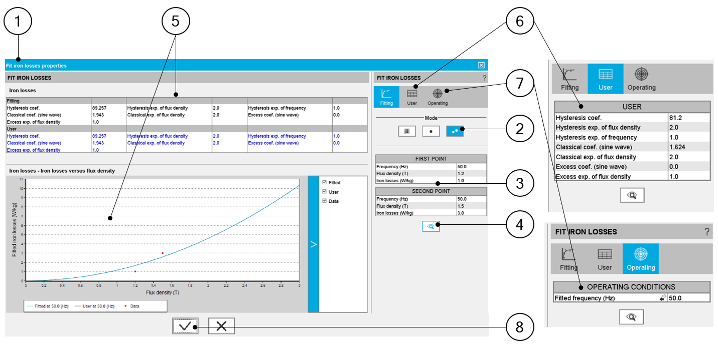

2.3 Case 2: From two measurement points
| Definition of iron loss coefficients – from two measurement points | |
| 2 | Choice of the method to find iron loss parameters (2 points in this example). |
| 3 | Measurement characteristics to give for each measurement point:
| 4 |
When input parameters characterizing the two measurement points are defined, click on the Fit button to run the optimization process. This process computes the set of iron loss parameters that allow targeting the considered measurement points. |
| 5 | The resulting iron loss input parameters are deduced and displayed in the result table and the corresponding curve; Losses versus B (magnetic flux density) is displayed. |
| 6 |
The user can adjust one or all the parameters of the iron losses model. To do so user tab must be selected by clicking on its icon. The resulting modification is directly in the outputs area. |
| 8 |
Firstly, the internal process uses a genetic algorithm to compute the iron loss parameters.
When the same frequency is considered for the two targeted points, this can lead to a disparity on the resulting iron loss parameters. It means that, the same set of inputs provide sets of iron loss parameters, which can be different. However, the resulting iron loss model gives the same total amount of iron losses.Note: The best way to use the method with two measurement points, is to consider two different frequencies. Thus, there is only one resulting set of iron loss parameters.It is highly recommended to take 2 different frequencies as boundaries of the working area.
Moreover, check that the classical losses coefficient is positive before using the resulting iron loss model. If this coefficient is negative, please check the relevance of the original data.
Secondly, defining the iron loss parameters, with frequency different from the one which is considered for the computation of a working point in Motor Factory, can lead to wrong results.

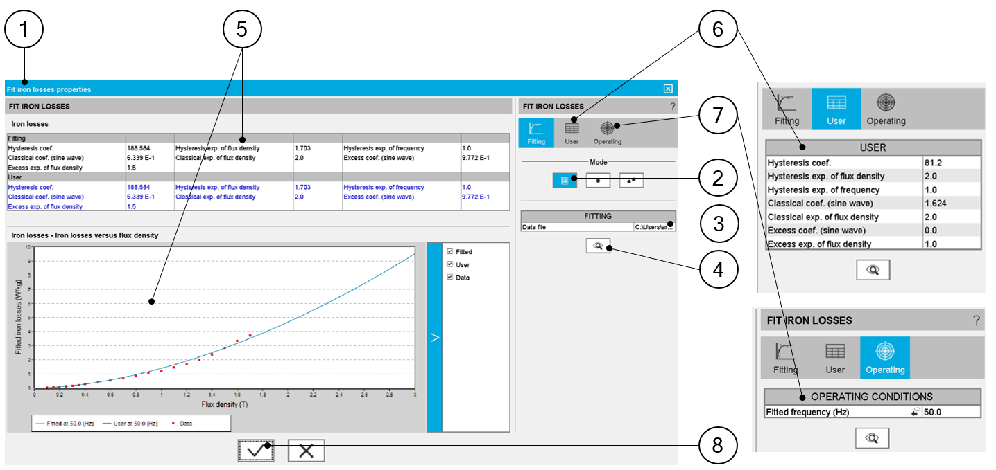

2.4 Case 3: From a map (file input)
| Definition of iron loss coefficients – from a map | |
| 2 | Choice of the method to find iron loss parameters (form input file in this example). |
| 3 | Select the Excel file inside of which several curves of iron losses with flux density functions are available for different values of frequency are defined. An example of file is shown below. |
| 4 |
When the Excel file is selected, click on the Fit button to run the optimization process. This process computes the set of iron loss parameters targeting the considered measurement points. |
| 6 |
| 8 |

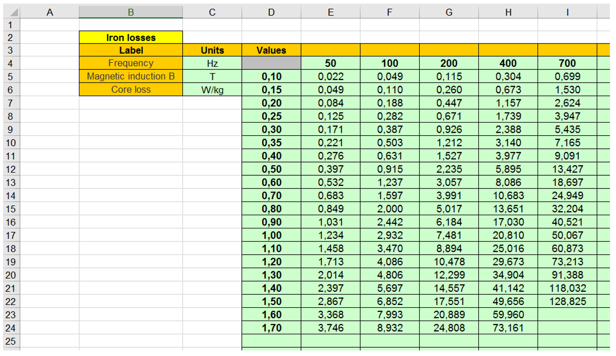

Example of an Excel file to define the curves of iron losses in function of flux density for different values of frequency.
This corresponds to a map of Iron losses in f - B plane (where f= frequency and B=flux density).
| Example of an Excel file to define iron loss parameters from a map |
