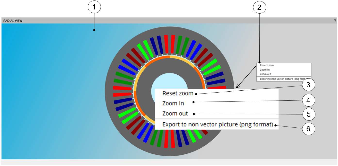

The graphic functions are available on every graphic area of the Motor Factory application.
| 1 | From the any graphic window it is possible to access the graphic functions by using the right mouse button. |
| 2 | A dialog box allows to choose among four functions:
| 3 | Reset zoom allows getting back the original size of the picture (i.e.
                        without zooming). Reset zoom allows making the picture recover its original size. |
| 4-5 | Zoom in and zoom out are used for adjusting the size of the picture,
                        step by step. Zoom in and zoom out can also be applied by using the scroll wheel on the mouse. |
| 6 | Export function to get a picture with .png format. The picture is captured by considering its original size (i.e. without zooming). |

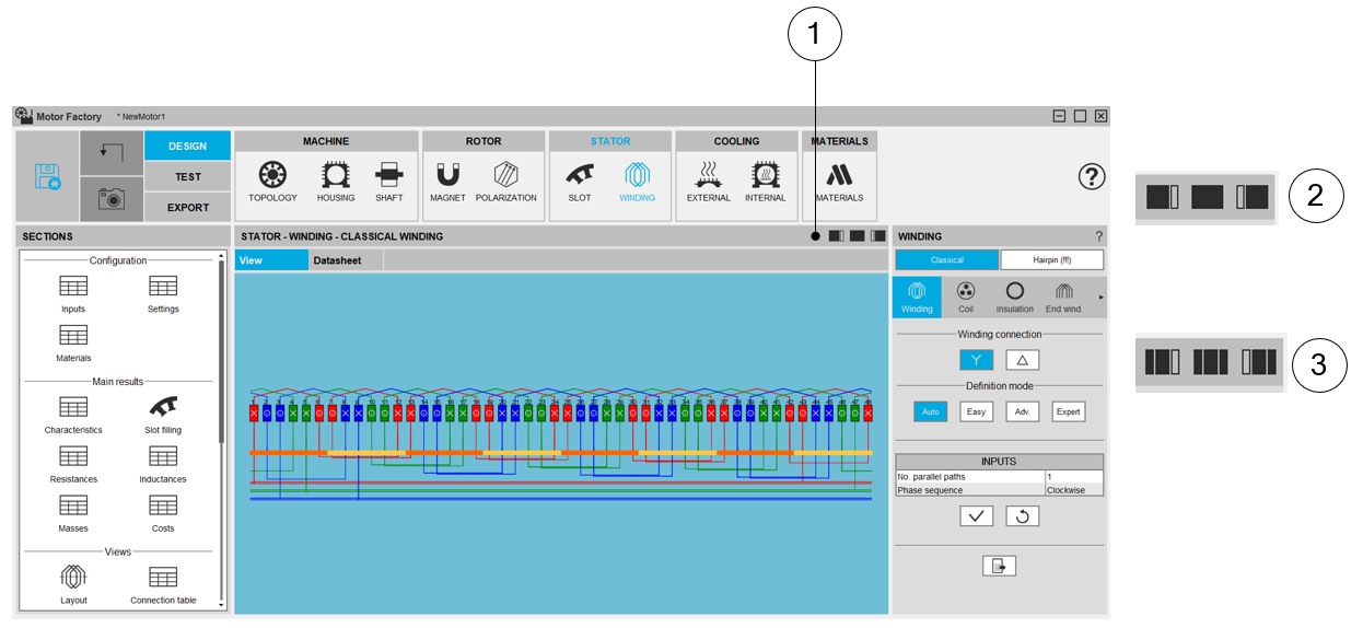

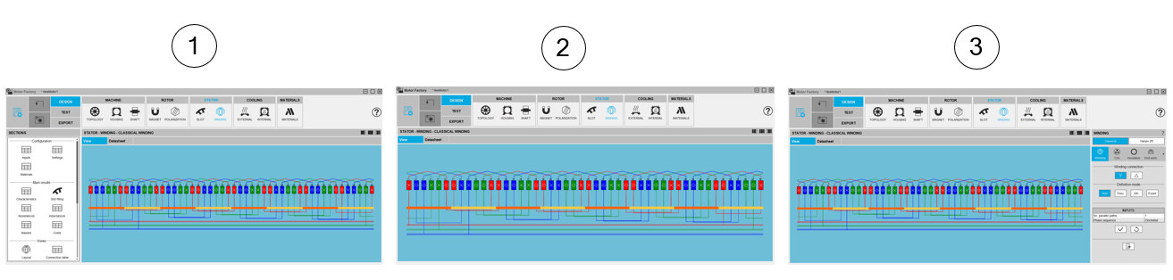

2. Management of panels in Motor Factory
When the computer screen is too small or when the resolution of the screen is too low, three buttons appear on the top part of Motor Factory panels.
They allow to remove or to display the right and/or left panels of the screen. See illustrations below.
| Dedicated buttons allow the management of panels in Motor Factory | |
| 1 | Three buttons are available to manage the displaying of panels in Motor Factory. |
| 2 | Button to hide right side and/or left side or both sides. |
| 3 | Button to display right side and/or left side or both sides. |
| Different ways to display (or remove) the panels in Motor Factory | |
| 1 | Right side removed and left side displayed. |
| 2 | Both sides (right and left) removed. |
| 3 | Right side displayed and left side removed. |

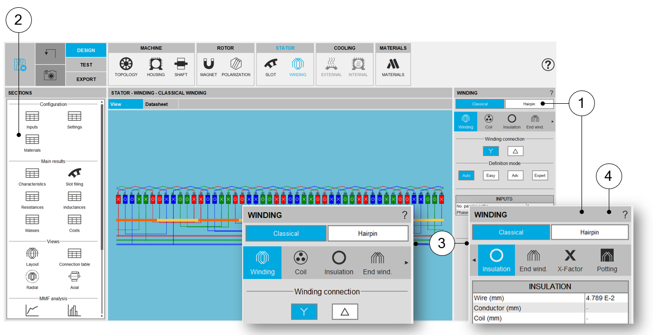

4.1 Section selection mode
The process for choosing the section in which user inputs are defined is implemented in the winding area as illustrated below
| Scrolling selection bar – Winding environment | |
| 1 | Scrolling selection bar where Winding, Coil, End-winding, X-Factor and Potting sections can be selected. |
| 2 | Section data can be reached thanks to shortcuts. |
| 3 | Arrow allows to scroll the bar to reach other sections (on the right or the left) when needed. |
| 4 | The bar slides on the right to allow reaching Potting section. |

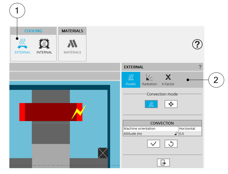

| Scrolling selection bar – External cooling area | |
| 1 | External cooling area of Motor Factory design environment. |
| 2 | Scrolling selection bar where Fluidic, Radiation, X-Factor sections can
                        be selected. In that case, all the sections can be reached without sliding the bar. |

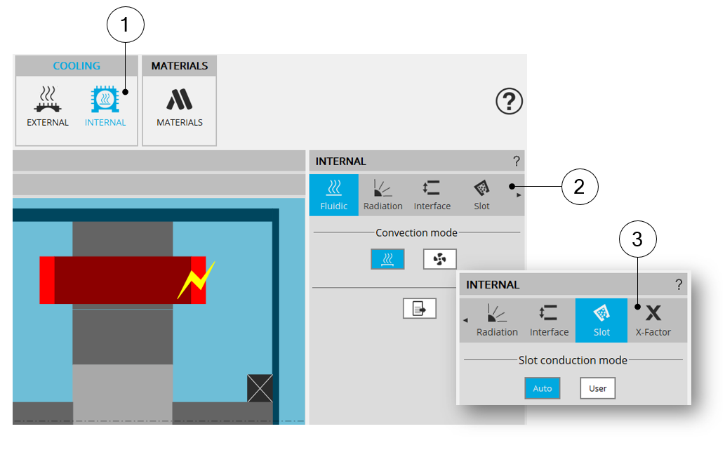

| Scrolling selection bar – Internal cooling area | |
| 1 | Internal cooling area of Motor Factory design environment. |
| 2 | Scrolling selection bar where Fluidic, Radiation, Interface, Slot sections can be selected. |
| 3 | The bar slides on the right to allow reaching X-Factor section. |

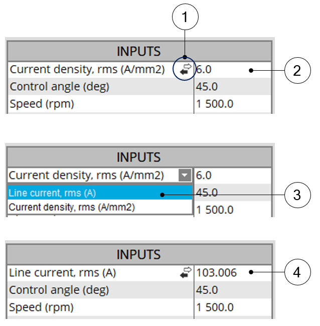

4.2 Multiple choices for inputs
A process allowing Multiple choices for selecting the type of user’s inputs has been implemented. This allow to give users several choices within only one input line. Please see the below example showing the different ways to define the electrical current in conductors.
| 1 | Icon allowing to give multiple choices to the users. |
| 2 | First choice = Current density (A/mm²). |
| 3 | In that case two choices are possible: either the current density or the
                        line current. Whatever is the choice the units and the corresponding data are updated. |
| 4 | Second choice = Line current, rms (A). |
