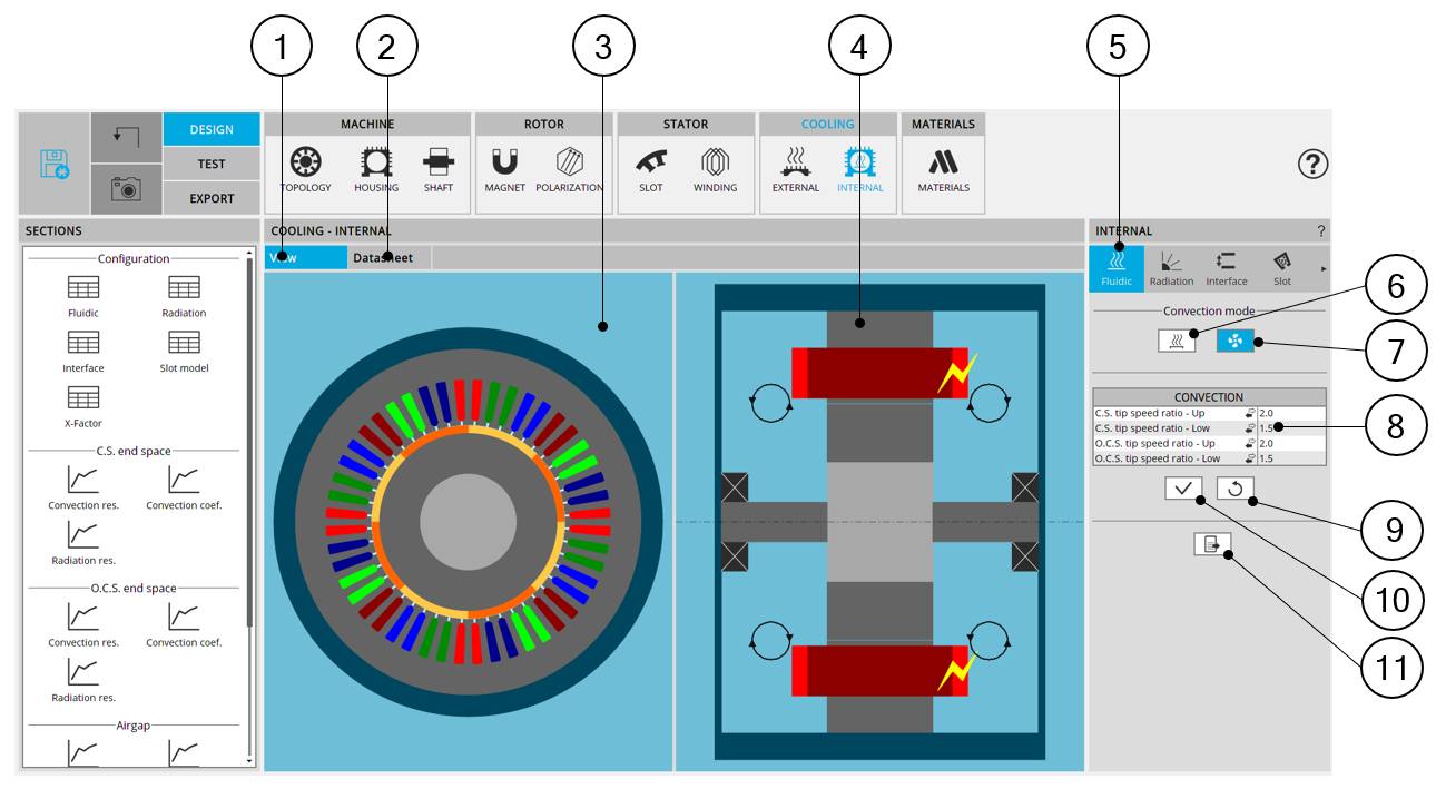

| Internal cooling - Fluidic design area | |
| 1 | Display the axial and radial view of the machine. |
| 2 | Display the internal cooling datasheet, showing the thermal parameters defining the internal heat exchanges. |
| 3 | Radial view of the motor, where specific exchange areas can be highlighted depending of the selected input. |
| 4 | Axial view of the motor, where specific exchange areas can be highlighted depending of the selected input. |
| 5 | The section “Fluidic” is selected. |
| 6 | Selected button to set that natural convection occurs in the end spaces (no specific fluid flow modeled in addition to the rotation of the machine). |
| 7 | Selected button to set that forced convection occurs in the end spaces (a specific fluid flow on each area of the end caps can be specify by the user, that can be linked to the machine rotation speed or not). |
| 8 | Input related to the fluidic corresponding to the selected convection mode. |
| 9 | Button to restore default input values. |
| 10 | Button to apply inputs. Pressing the enter key twice applies inputs too. |
| 11 | Icon to export internal cooling data into *.txt or *.xls files |

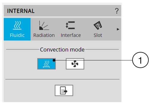

| Natural convection - Inputs | |
| 1 | Natural convection mode is selected. In this mode, there is no input to define. |

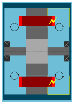

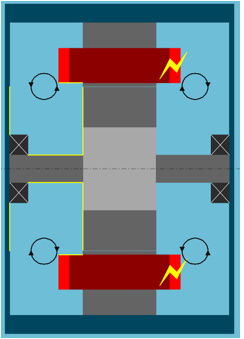

When selecting one of these four inputs, the corresponding exchange areas are highlighted in the axial view of the machine.
See below illustrations.
| Opposite Connection Side “Upper” region – far from the rotor | Connection Side “Upper” region – far from the rotor |
| Opposite Connection Side “Lower” region – close to the rotor | Connection Side “Lower” region – close to the rotor |

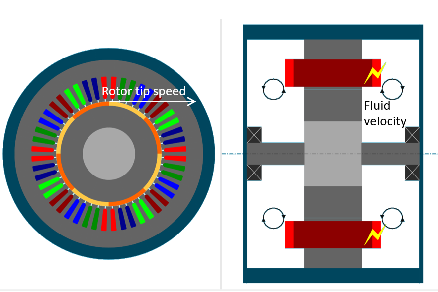

The « Tip speed ratio » input mode allows setting a fluid velocity proportional to the rotor tip speed.
| Definition of the fluid velocity proportional to the rotor tip speed |
This can be used to model a shaft mounted fan, of rotor fins.

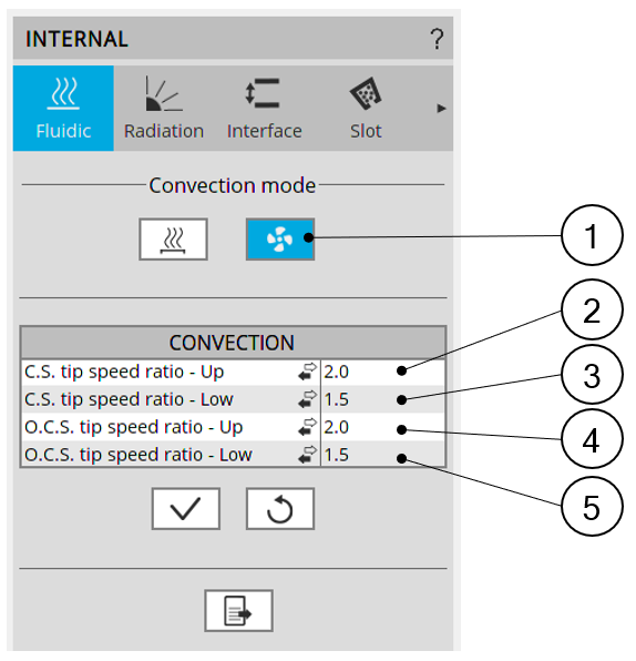

| Forced convection - Inputs | |
| 1 | Forced convection mode is selected |
| 2 | Input related to the Connection Side “Upper” region, here set as a tip speed ratio |
| 3 | Input related to the Connection Side “Lower” region, here set as a tip speed ratio |
| 4 | Input related to the Opposite Connection Side “Upper” region, here set as a tip speed ratio |
| 5 | Input related to the Opposite Connection Side “Lower” region, here set as a tip speed ratio |
