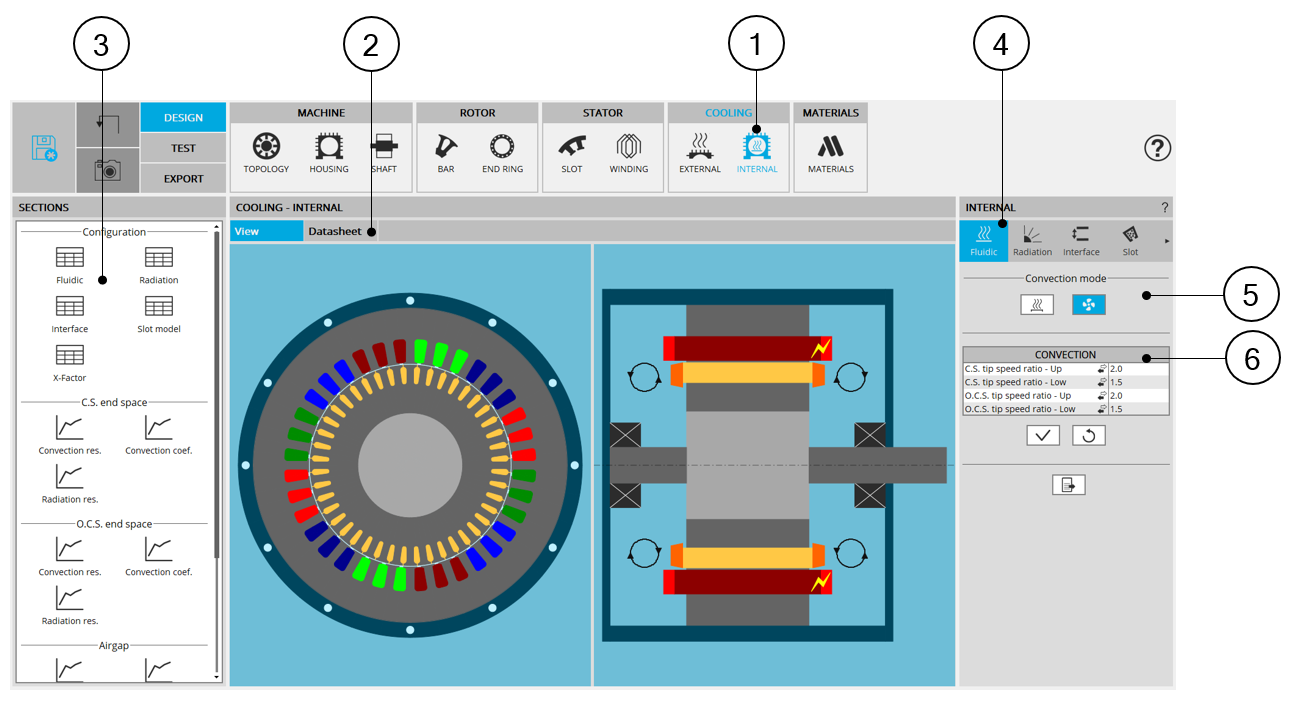

| INTERNAL COOLING design area - Overview | |
| 1 | Selection of the COOLING subset: INTERNAL panel (Click on the icon INTERNAL) |
| 2 | Once the internal cooling parameters are defined, corresponding results are automatically displayed in form of datasheet. Visualization of the internal cooling characteristics (inputs, and corresponding results) is possible. Scrollbars allow browsing the whole document rapidly and having an overview of all the results. Using scrollbars, complete data can be accessed and visualized. |
| 3 | Shortcuts for displaying the corresponding chapter of the internal cooling datasheet. |
| 4 | Internal cooling settings allow describing the internal cooling parameters. |
| 5 | Choice of the internal convection mode: natural or forced. |
| 6 | Inputs defining the convection (forced or natural, corresponding to the choice above). |
