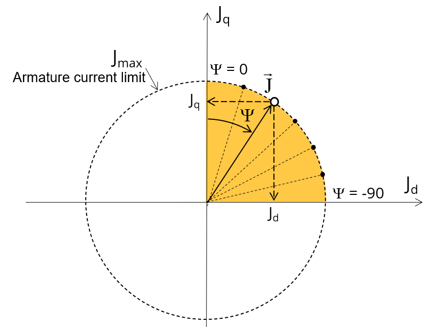

3.1 Number of computations for control angle
Considering the vector diagram shown below, the control angle Y is the angle between the Q-axis and the electrical current (J) (Y = (J q , J)).
The computation to get the corner point location is performed by considering control angle (Y) over a range of 0 to 90 electrical degrees. The user input “ No. comp. for ctrl. angle ” (Number of computations for the control angle) allows to choose between accuracy of results and computation time by using a number of computations between and . The variation area for is represented by the quarter circle (colored yellow in the diagram). This discretization is necessary to find the working point corresponding to the base speed point of the torque-speed curve.
The default value of Number of computations for the control angle is equal to 5. The minimum allowed value is 5.
| Variation area for control angle Ψ |

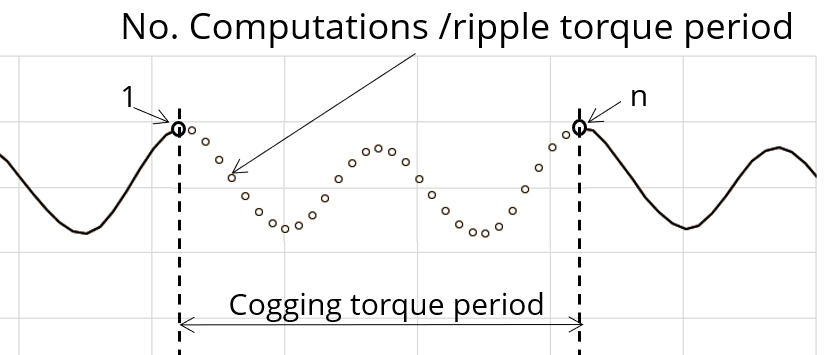

3.2 Number of computations per ripple torque period
The number of computations per ripple torque period is considered when the user chooses to perform a “Ripple torque analysis” (i.e. answered “Yes” to the standard input “Ripple torque analysis”.
The user input “ No. comp. / ripple period ” (Number of computations per ripple torque period) influences the accuracy of results (computation of the peak-peak ripple torque) and the computation time.
The default value is equal to 30. The minimum allowed value is 25. The default value provides a good compromise between the accuracy of results and computation time.
| Definition of the number of computations per ripple torque period |
