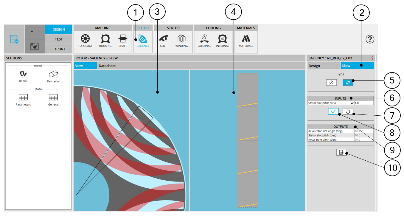

                     | BAR – SKEW design area |
                     | 1 | Selection of the ROTOR subset: SALIENCY panel (Click on the
icon SALIENCY) |
                     | 2 | SKEW tab indicates the tools to define the rotor (saliency)
skewing angle |
                     | 3 | Visualization of the motor radial view with saliency topology
and dimensions. |
                     | 4 | Visualization of the rotor developed view to visualize the
rotor (saliency) skewing |
                     | 5 | Choices to define a skew: None – Continuous (Continuous
in our example) |
                     | 6 | Skew inputs to be defined |
                     | 7 | Buttons to restore the default input values |
                     | 8 | Buttons to validate the inputs (Pressing the “enter
key” twice applies inputs too). |
                     | 9 | Skew outputs (read only) |
