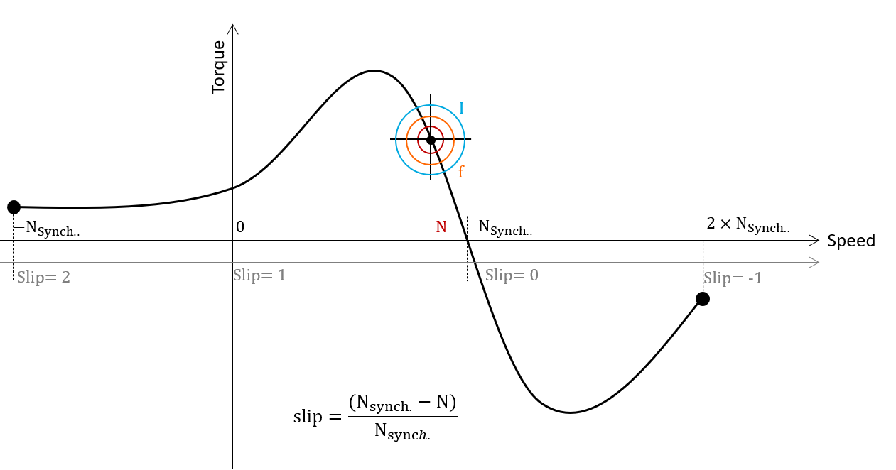

The aim of the test “Mechanics – NVH – Working point – I-f-N” is to perform NVH analysis of the machine when operating at the targeted working point defined with the following inputs values I, f, N (Line current, Power supply frequency, Speed).

| “Working point – Sine wave – Motor – U, f, N” Illustration |

The three main user input parameters are the Line current, the power supply frequency and the speed. In addition, temperatures of winding and squirrel cage must be set.
