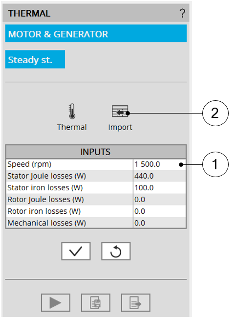

| How to define a set of losses | |
| 1 | Fill in the table to define the speed and all the losses to be considered |
| 2 | Click on the button “import” to import inputs corresponding to a solved
                        test. All existing data of the selected test will be imported into the inputs of the thermal characterization. The data which does not exist in the outputs of the selected test are set to 0. |
