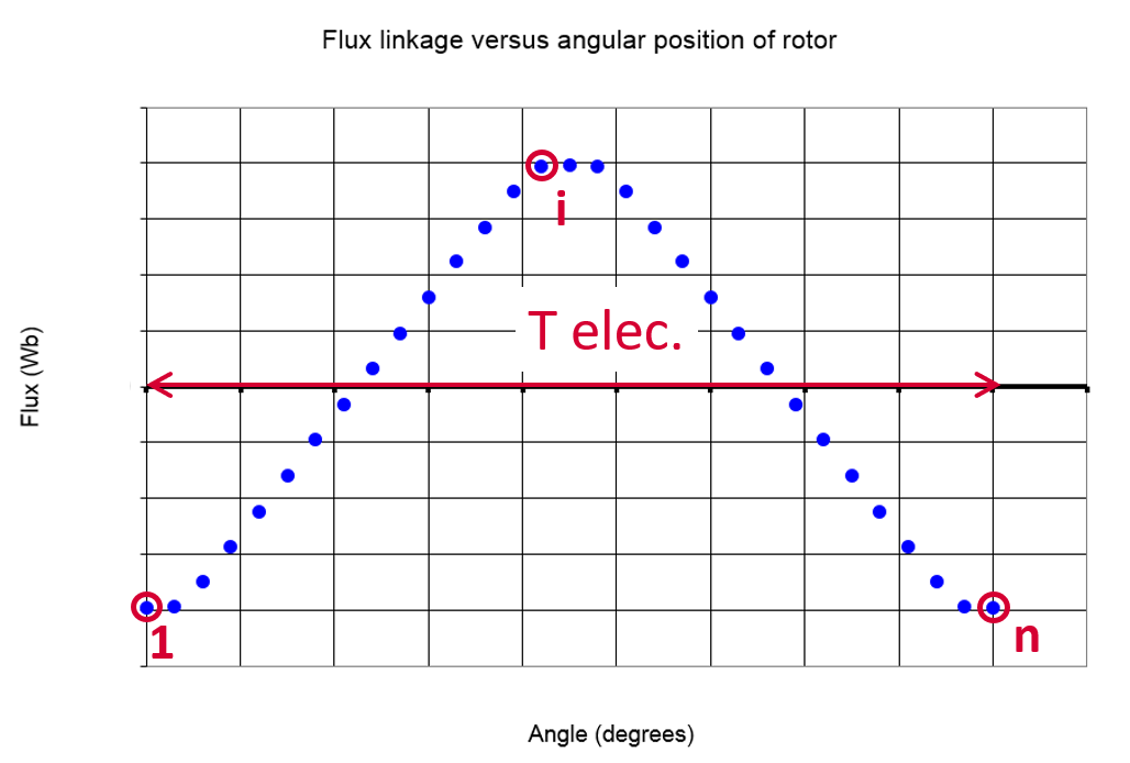

3.1 Number of computations per electrical period
To get the Back-EMF versus time, the flux through each phase of the machine versus rotor angular position is computed.
This computation is performed using a Finite Element Modeling (Flux software).
The number of computations per electrical period “ No. comp. / elec. period ” (Number of computations per electrical period) influences the accuracy of results and the computation time.
The default value is equal to 50. The minimum allowed value is 13. This default value provides a good compromise between the accuracy of results and computation time.
The result on a whole electrical period is rebuilt from the raw data.
| Number of computations per electrical period |
