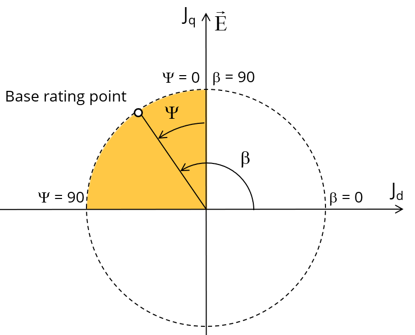

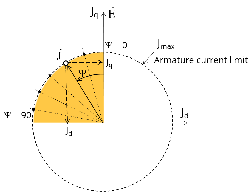

3.1 Number of computations for the control angle
Considering the vector diagram shown below, the control angle Ψ is the angle between the electrical current (J) and the electromotive force E (Ψ = (J, E)).
The computation to get the corner point location is performed by considering control angle (Ψ) over a range of 0 to 90 electrical degrees.
The user input “ No. comp. for ctrl. angle ” ( Number of computations for the control angle) allows to choose between accuracy of results and computation time by using a number of computations between Ψ = 0º and Ψ = 90º.
The variation area for Ψ is represented by the quarter circle (colored yellow in the diagram). This discretization is necessary to find the working point corresponding to the base speed point of the torque-speed curve.
The default value of Number of computations for the control angle is equal to 5. The minimum allowed value is 5.

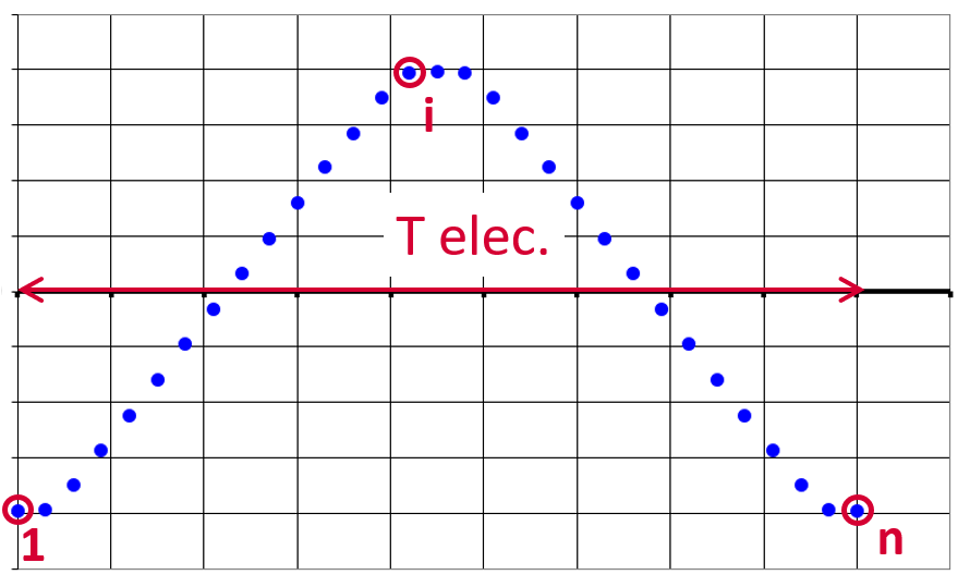

3.2 Number of computations per electrical period
For analysis like open circuit - Back-EMF or unsaturated inductances, performed over an electrical period, the user input “ No. comp. / elec. period ” (Number of computations per electrical period) influences the accuracy of results and the computation time.
Computations over electrical period are performed using a Finite Element Modelling (inside Flux software).
The default value is equal to 50. The minimum allowed value is 13. The default value provides a good compromise between the accuracy of results and computation time.
For computing the open circuit machine performance, the process is the same as in the “Characterization – Open circuit – Motor & Generator – Back-emf.
In that case, the raw computations are performed over one electrical half period. The result on a whole electrical period is rebuilt from the raw data.
The real number of computations per electrical period can be equal to the requested one +/- 1.
For the computation of unsaturated inductances, the requested number of computations over the whole electrical period is directly applied.
At last, the number of computations per electrical period displayed in outputs is always the requested one even if there is a little difference (+/- 1) with the one used for the computation of back-emf.

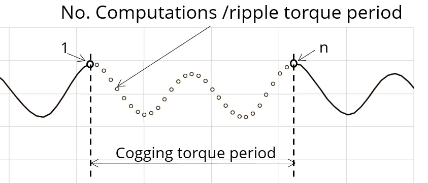

3.3 Number of computations per ripple torque period
To compute peak-peak ripple torque more precisely, the user input “ No. comp. / ripple period ” (Number of computations per ripple torque period) influences the accuracy of results and the computation time.
It has also a significant impact on the computation of the magnet behavior as well as on computation of the flux density in iron.
The default value is equal to 30. The minimum allowed value is 25.
| Definition of the number of computations per ripple torque period |
