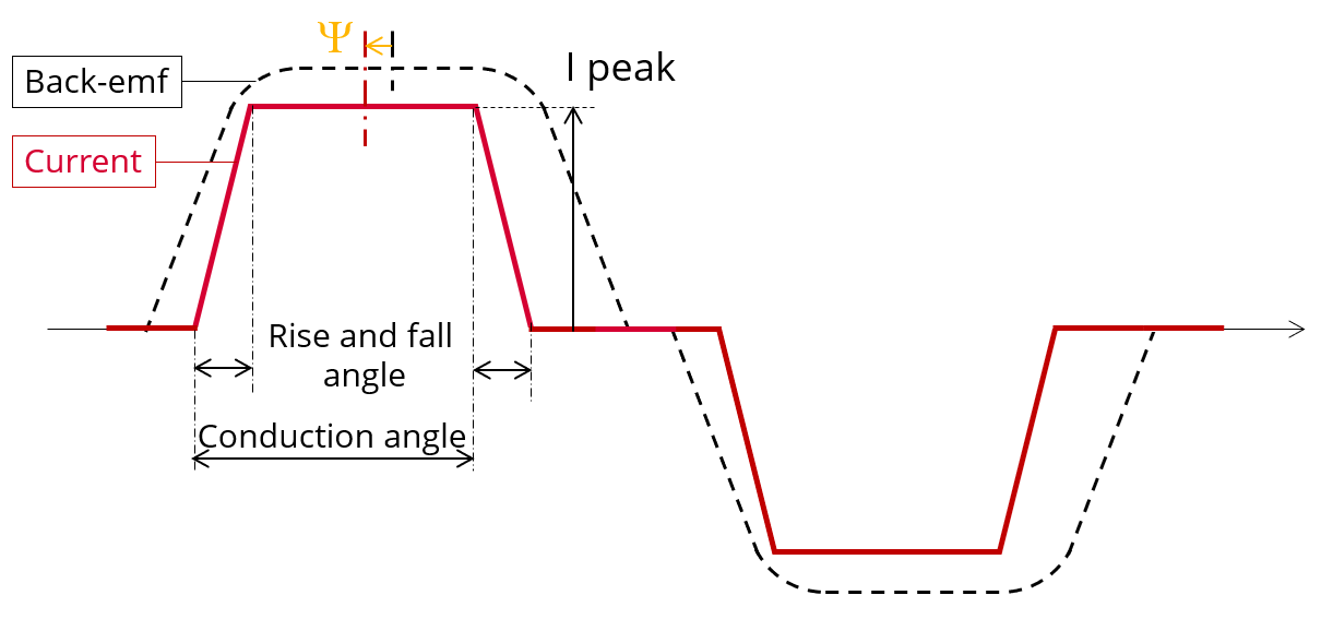

A parameterized trapezoidal shape current defines the line current.

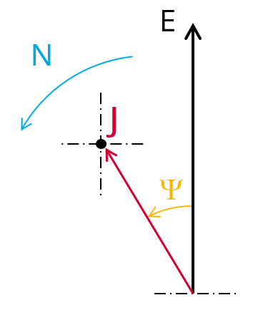

The control angle between the back-emf and the phase current, the value of current and the imposed speed induce the resulting working point. Then, the main corresponding performance are computed and displayed.
| Working point – Square wave – Motor – Forced I - Illustration | |
