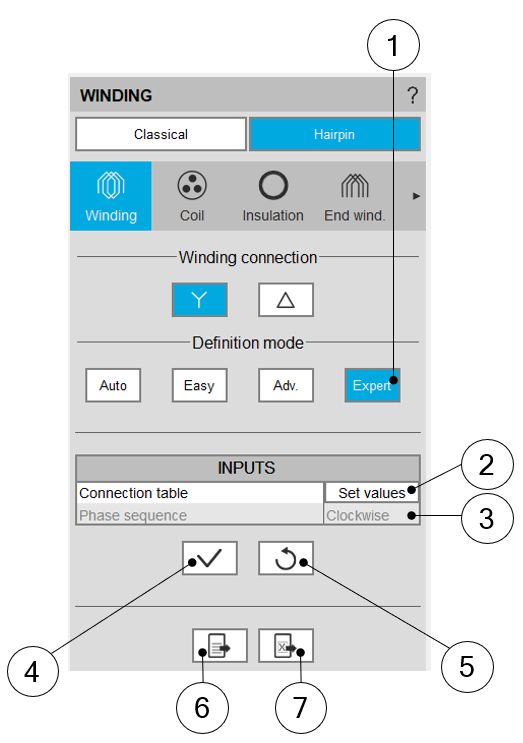

2. Main principles
| Building the winding architecture - Expert mode | |
| 1 | Selection of the Expert mode for building the winding architecture. |
| 2 | “Set values” means opening the dialog box to fill the connection table. See illustration below. |
| 3 | Definition of the phase sequence i.e. the rotation direction of the
                        Magneto-Motive Force (M.M.F): Clockwise or Counter clockwise.The rotation direction is defined when facing the machine on the connection side. The phase sequence is set to clockwise and cannot be modified in the current version (grayed field). |
| 4 | Button to apply inputs. Pressing the enter key twice applies inputs too. |
| 5 | Button to restore default input values. Default values are those which define the winding architecture by using the automatic mode. |
| 6 | Icon to export winding data into *.txt or *.xlsx files. |
| 7 | Icon to export hairpin winding connection table into a *.xlsx
                           file. This file can be shared and reloaded in another FluxMotor® session. |
