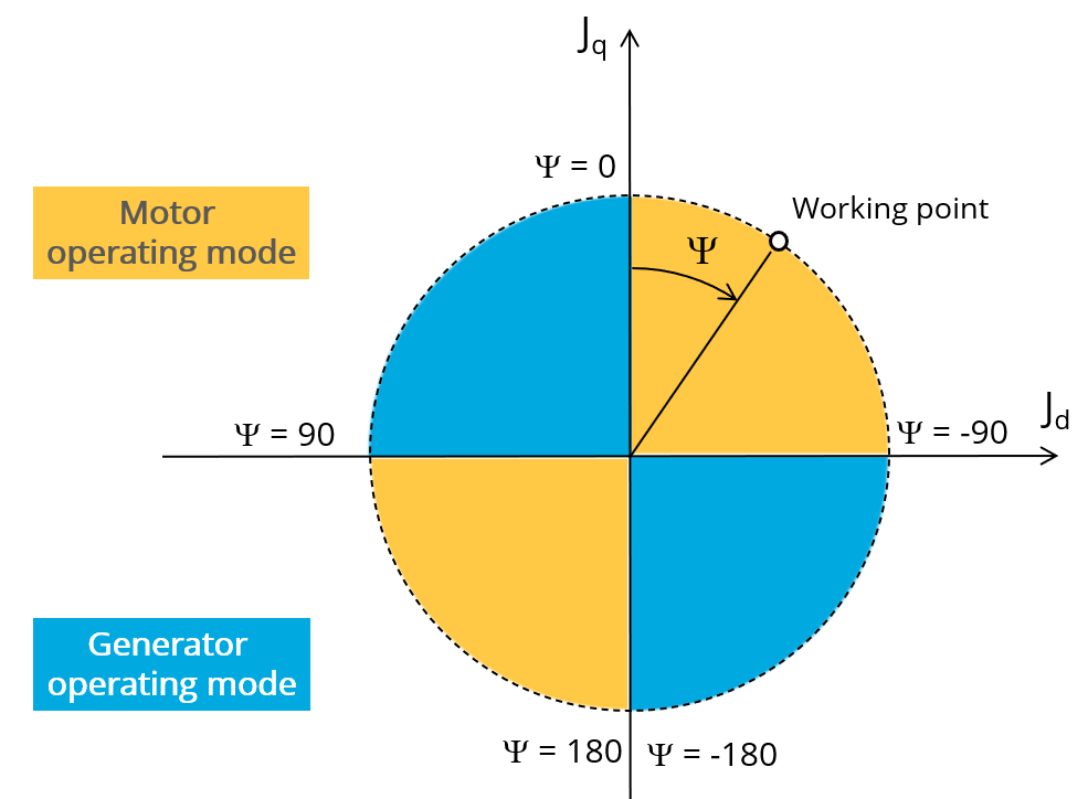

                    Control angle Considering the vector diagram shown below, the “ Control angle ” is the angle between the Q-axis and the electrical current (J) (Ψ = (J q , J)). It is an electrical angle. The default value is 45 degrees. It must be set in a range of -90 to 90 degrees. This range of values covers all the possible working point in motor convention.
 Definition of the control angle Ψ - Motor convention
