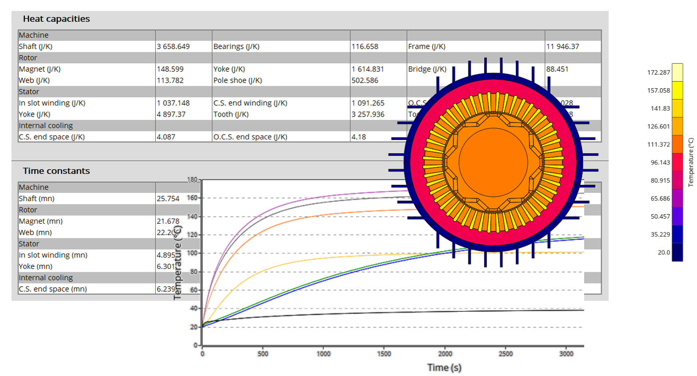

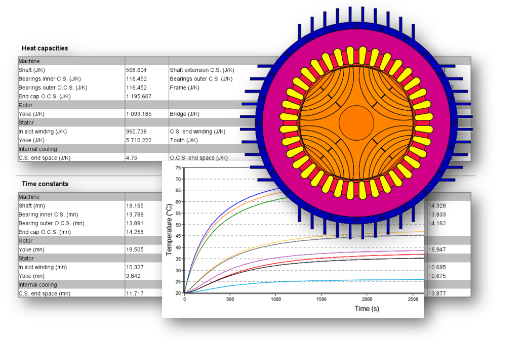

3. Main outputs
Here are the main results available:
- Temperature charts versus time – radial and axial view
- Main temperature curve versus time and final temperature table
- Heat capacity and time constant table
| Illustration of results |
