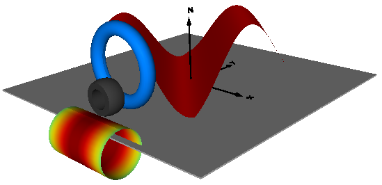

| Surfaces | Demonstrate the visualization of a sine surface,
as well as a torus and a wheel constructed from a surface

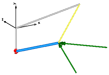

Model Modelica.Mechanics.MultiBody.Examples.Elementary.ForceAndTorque
In this example the usage of the general force element "ForceAndTorque" is shown. A "ForceAndTorque" element is connected between a body and a fixed point in the world system. The force and torque is defined by the "Constant" block. The two vectors are resolved in the coordinate system defined by the "fixedRotation" component that is fixed in the world system:
The animation view at time = 0 is shown in the figure below. The yellow line is directed from frame_a to frame_b of the forceAndTorque component. The green arrow characterizes the force acting at the body whereas the green double arrow characterizes the torque acting at the body. The lengths of the two vectors are proportional to the lengths of the force and torque vectors (constant scaling factors are defined as parameters in the forceAndTorque component):

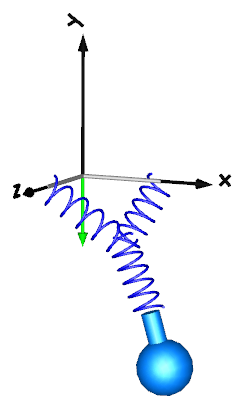

Model Modelica.Mechanics.MultiBody.Examples.Elementary.FreeBody
This example demonstrates:
Extends from Modelica.Icons.Example (Icon for runnable examples).

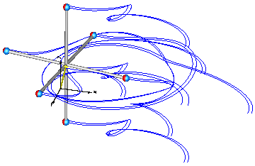

Model Modelica.Mechanics.MultiBody.Examples.Elementary.PointGravityWithPointMasses2
This model demonstrates the usage of model Parts.PointMass in a point gravity field. 6 point masses are connected rigidly together. Translating such a model results in an error, because point masses do not define an orientation object. The example demonstrates that in such a case (when the orientation object is not defined by an object that is connected to a point mass), a "MultiBody.Joints.FreeMotion" joint has to be used, to define the degrees of freedom of this structure.
In order to demonstrate that this approach is correct, in model "referenceSystem", the same system is again provided, but this time modeled with a generic body (Parts.Body) where the inertia tensor is set to zero. In this case, no FreeMotion object is needed because every body provides its absolute translational and rotational position and velocity as potential states.
The two systems should move exactly in the same way. The system with the PointMasses
object visualizes the point masses in "red", whereas the "referenceSystem" shows
its bodies in "blue".

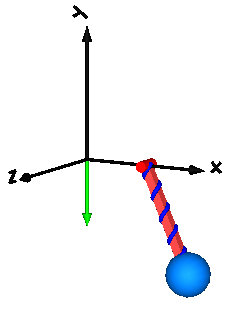

Model Modelica.Mechanics.MultiBody.Examples.Elementary.SpringWithMass
This example shows that a force component may have a mass. The 3-dimensional spring as used in this example, has an optional point mass between the two points where the spring is attached. In the animation, this point mass is represented by a small, light blue, sphere.

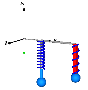

Model Modelica.Mechanics.MultiBody.Examples.Elementary.ThreeSprings
This example demonstrates that 3-dimensional line force elements (here: Modelica.Mechanics.MultiBody.Forces.Spring elements) can be connected together in series without having a body with mass at the connection point (as usually required by multi-body programs). This is advantageous since stiff systems can be avoided, say, due to a stiff spring and a small mass at the connection point.
For a more thorough explanation, see MultiBody.UsersGuide.Tutorial.ConnectionOfLineForces.

Model Modelica.Mechanics.MultiBody.Examples.Elementary.Surfaces
