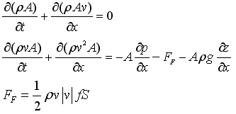

The basic idea of the FluidPort connector is that 2 or more components can be connected together at a point and that automatically the mass and energy balance is fulfilled in the connection point, i.e., the ideal mixing equations are generated. Note, the momentum balance is only correct for straight line connections. If "ideal mixing" is not sufficient, a special component to define the mixing equations must be introduced.
The mass and momentum balance equations in a component are derived from the partial differential equations along the flow direction of a pipe:
Note, FF is the fanning friction factor. The energy balance can be given in different forms. Usually, it is given as:
